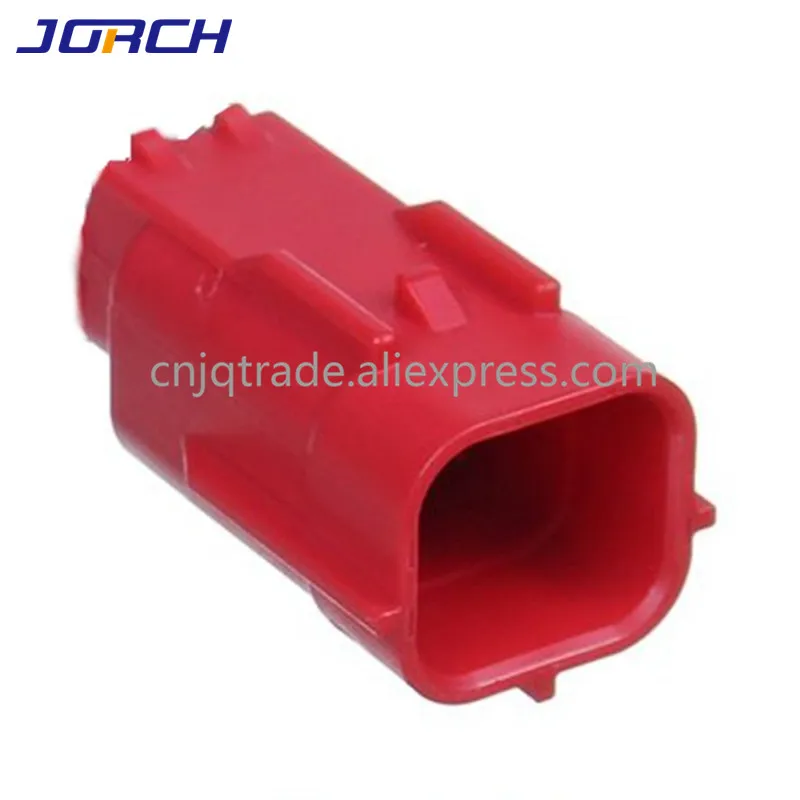

The pins I used in my video were from this connector kit I ordered from AliExpress. I actually made a working plug, but for the video I just made a wire with the pins crimped on to show that's all you need. I only had 18g wire which is to big to fit in the holes so I used a couple of the pins. The pins are .6mm and 22g wire is .64mm, so I assume a few inches of 22g wire is all you need.
