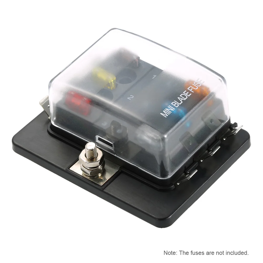

Blade fuses come in three sizes. I ordered a 6 terminal fuse block for the mini size. 10 bucks and change straight from China. I'll let you know how cheesy or not cheesy it is. You can't be in a hurry for stuff imported from China.
It looks suspiciously like this $32 unit from Ebay:
#9 ·
This is the one I got. I mounted it in the tail section. I cut those mounting tabs off for the California CARB stuff as I have a Wisconsin- spec bike; runs on beer & cheese soup. 😛
The unit is well made, quality hardware, and has a snap on cover. I used #10 AWG wire and loop eyelets to hook it up to the battery.
