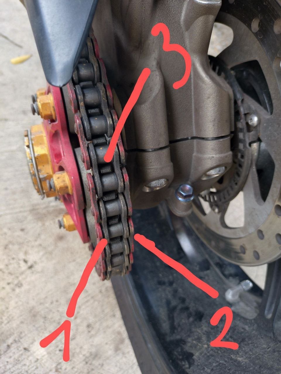

#459 ·
Sorry for stupid question probably but still.. Should I lube only the inside part(3) Or sideways also(1 and 2) I know it's outer part in the picture, it's just for example, I lube the inside of the chain. Based on youtube videos and comments on how to properly lube the chain there are some mixed opinions for some reason

The between the links parts are bushings. (#3) they mitigate the friction and loads associated with links mating with the sprocket teeth. there is need for lube to be inside of these bushings as well as the surface you see. The rubber gaskets, or 0-rings are squeezed between the plates to seal in the semi-permanent grease inside. The 0-rings benefit from being oily so they don't bind and twist when the chain flexes around the sprockets. caked hard crud wedges underneath these gaskets and lift the rubber, breaking the seal to the inner pins. Oil keeps the crud soft and extends the life of the seal. The crud-paste flings off to make a mess but carries the crud away. The part you can't see is the inner pins with the riveted heads. The actual load bearing parts. The factory packs the grease in there during assembly and it lasts a good long while- but not forever. When even one! pin seizes up... the chain is to be replaced as soon as possible. This joint is not following the circle around the countershaft sprocket and will snap as a result. A desperation move is to cut the 0-ring away and try penetrating oil to free the rust causing the seizure of this one link- to free it. That advice is sure to cause comments but I offer it as a 'get you home, once' shade tree kludge. Before 0-rings, all chains were bathed in oil to keep the pins lubed.
There is good reason automatic chain oilers extend the life of a drive chain. A constant supply of oil.
