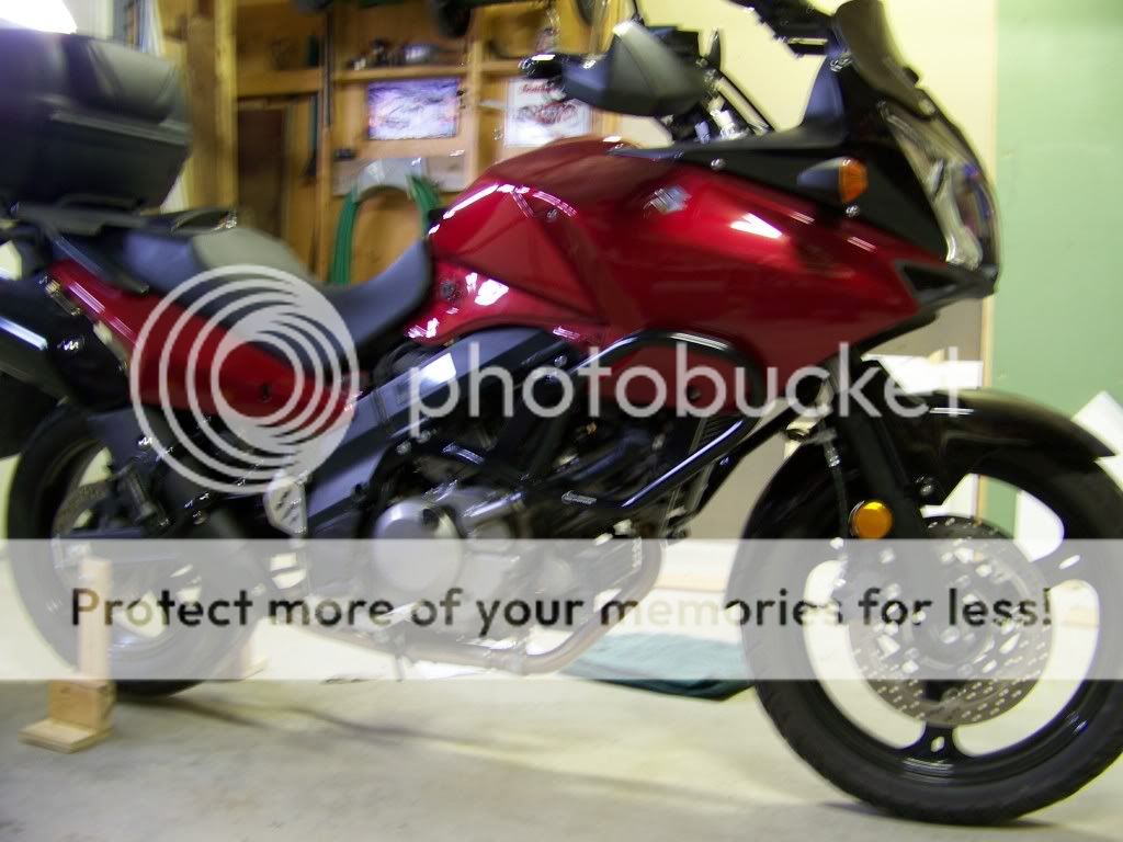

Do the work right after a ride. Chain is hot and dry. Remove the guard. Wipe it off with kerosene and a rag. Apply the lube of choice and wipe excess off as you go. Remove the counter sprocket cover once or twice per year and clean the crud out that accumulates in there, and you should be OK. I made a stand to hold mine up but there are many worthwhile stands on the market. If you get a stand the job is so easy, you will do it more often. The center kick stands allow you to do the work any time, and almost anywhere..

3. (Not related directly to topic) Can you post instructions (and sharper images) of your custom made stand. I really like that concept of a stand just for maintenance.
