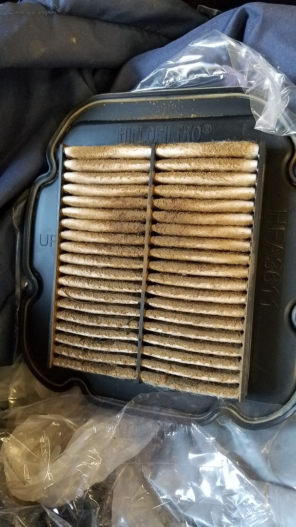

So I purchased my ‘12 Wee in August ‘18. It’s been spot on as I put 2k or so miles on it. Now sitting at 30k, I’m doing some maintenance. (Oil change, valve adjust, brake fluid & coolant change, etc.)
At the Air Filter stage, I purchased an OEM Filter at my local dealer. Upon opening up the air box (thanks to @DSRider650 & @Bemidjipaul for the wonderful tutorials) I observed the red pleated paper filter installed. The paper Filter was very clean, but the attached photos will show the difference between the OEM Filter & the paper replacement. The OEM appears much more robust.

eff likes this.

Either filter is fine. If the red one is clean, even down in-between the pleats where the bugs end up, just reinstall it and save the OEM for a later date.

If the red one isn't too impregnated with dust, just tap out the bugs (hitting the intake side down on a hard surface) and reinstall.

A HiFlo also has white medium ( I just took delivery of one), not red, but yours looks as new in the pics. Tap, reinstall and save the new one for when you need it.

The red Hi flow filter looks brand new so I cleaned it & re installed. Thanks all
