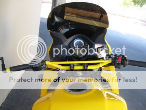

Not sure how those MX bars will lower your hands compared to the stock bars on the Strom.
I did buy those exact bars to try to make my SV650s into a Pre-Strom.
The project included changing the upper tripletree, adding the blocks and bars, changing the brake cables and rerouting the throttle, clutch cable other wiring. The seat was leveled, and I scrounged up an old six-pack rack from the front of a quad and reworked it into a usable tailrack.
Then, after staying off the lithium for a week, I welded up a new fairing mount that raised the fairing three inches and forward one inch. The original mirrors were frame mounted on the SV. The new ones are meant for a mountain bike. They had a built-in shock absorber, so they were very good on the bar ends and they cost $14 each if I remember correctly.

New bars just arrived. They're white, like my Wee, and the rise is a little more that I thought it would be, but that's probably good, so I can manage to clear the tank at full lock. Both the sweep and the rise seem about half of the stock bars and I will try to mount them today at lunch (I rode to work) just to see if they will allow the fork to turn lock-to-lock without contact. I remain optimistic about the more sporty outcome.
StrominNormin: I did evaluate loosing the fairing and may yet go that route, but the price of the pieces and parts for the modified headlight mount are out of range for my wallet right now. Stay tuned...
It took me a little over an hour to install the Fly Racing bars. I was working slow and taking my time, but they fit and the levers clear the fairing nicely, which was my biggest worry. I had to clip the nubs off of the controls on each side, instead of drilling into the bar, to re-attach but I don't anticipate any problems. The levers re-attached without issue and I even get room for my RAM mounts at the riser. No time over lunch for a test ride, so I don't know how they feel except for sitting on seat and adjusting the mirror...gosh, I wonder if I remember to plug in the clutch lock out wires? Hummm....
