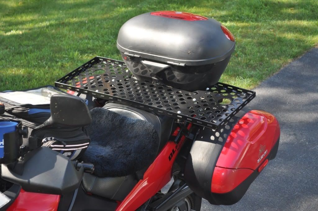

Instead of just strapping stuff like my sleeping bag, tent, gas can's etc to the seat, I figured I would try to design and make my own platform. I made the support bars out of 1" square steel, and the platform will be 3/16" aluminum that I will get water jet cut. Here's what I have made up so far.
Just finished welding the nuts on and sandblasted
fresh paint
Starting the cardboard template
Bolted down to check spacing and general fit
I have to finish measuring it all out for lightening holes and a couple big holes for access to the bag locks. The final product will also have a 1" tall border around it so nothing slides off.

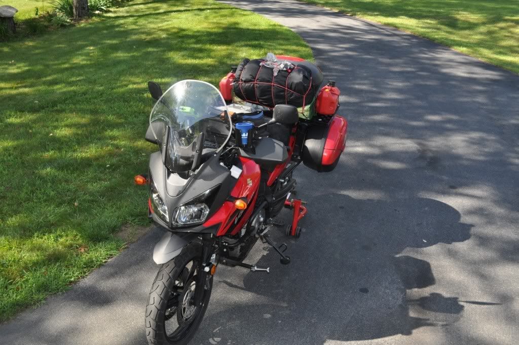

After one year, I FINALLY have it done.. it took the shop 6 weeks to make instead of the one he promised but in the end I'm pretty happy with it. This will maybe make the trip across the TLH a little easier

all the holes are the same size except for those larger ones. what gives??
