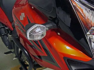

OEM turn signal:
Inner fairing showing mounted OEM signal:

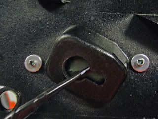

Fairing opening with signal removed:

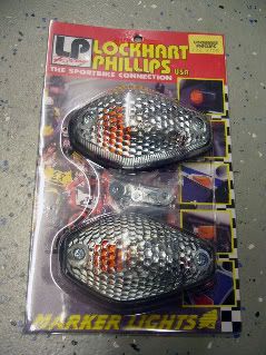

New Flushmount III's:
Flushmount III's (Suzuki wiring harness adapters at bottom of picture):

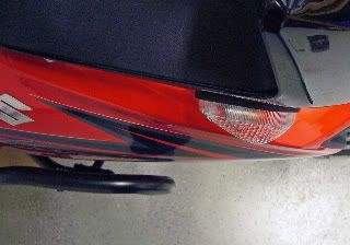

Outer mounting picture. Note close proximity of fairing mounting bolt in lower right. Care must be taken to allow clearance for this bolt:
Inner mounting picture. Care must be taken when drilling mounting holes to allow clearance for mounting the washers under the rivets:

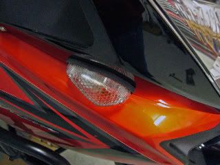

Finished install:
Nicely recessed to avoid damage:
