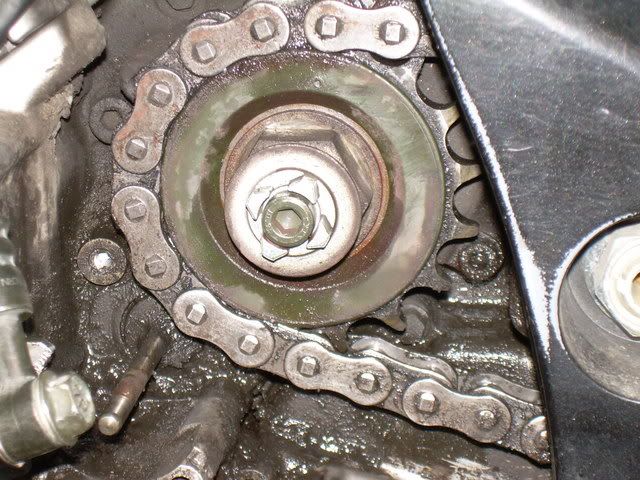

I then removed the Clutch Slave Unit and the Sprocket cover:
Next I removed the Speed Sensor Trigger unit from the counterShaft and The 32mm Sprocket retaining nut was only FINGER Tight!!:mad:
After removing the Worn front sprocket, I decided to see how it looked against a "new" sprocket
Not Great But 16400 miles in 9months of riding Is a good base line to keep track of this new set..

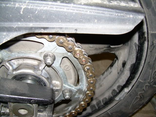

It is EXTREEMLY IMPORTANT That you measure the chain 2 times and mark the link so that you have 2 Female ends!!!! I ended up adding a a Link to mine :mad: and re-peening it too. Heres the new chain installed on the old sprocket :
The New chain & rear sprocket installed & ready for test ride!..

I did the same on my DL1000 yesterday. Did you replace the rear sprocket with a 43 tooth as well? I did and found the chain is either way too loose or too tight. I opted for tight to allow for future tightening but ran out of adjustment to slack the chain and it is not perfectly aligned, as the right adjuster doesn't back off as far as the left. I'm going to pull the axle again, try replacing the adjuster locknuts with thinner ones or using a shorter adjuster bolt, or both. Just not comfortable with the chain this tight (3/4 an inch of slack) and slightly misaligned. Had over 18k miles on the stock chain, front sprocket looked just like yours, and the 32mm nut was not tight when I pulled it (The loctite had dried out and left a fine red dust inside the sprocket cover).

Do you mean the chain is too tight in part of the rotation and too loose in another part? That and the red dust mean the chain needs to be replaced. Isn't that what you are doing though? Never adjust a chain tighter than spec. It will wear out in a hurry.
I jus finished the exact same swap. There was 10,000 km on the bike, and when the sprocket was put on I was at the very end of the adjustment range. Absolutely no more slack adjustment. Noticed the bolts were not quite even as well, with one being about 1/8" farther out from the nut than the other. But the axle assembly lines up with the swingarm marks on both sides and I believe that is the goal.

The swingarm marks and the adjuster bolts can both be off relative to each other. The goal is to get the axle perpendicular to the centerline of the bike. With the stock axle spacers, that will cause a an offset of the sprockets on DL1000s with the rear being out 2mm farther from the centerline than the front. That's why you see so many references to Master Mike spacers here. Trying to line up the rear sprocket with the front sprocket using stock spacers will cock the rear wheel slightly to the right.
