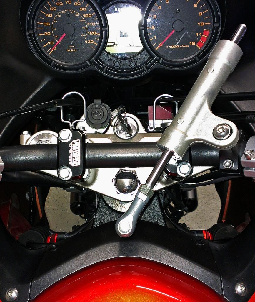

I own an SV650 as well as a DL650. I have a steering damper installed on the SV650, which uses a $20 eBay unit from a 2000's era GSXR, and mounts under the headlight via nicely CNC'd aluminum brackets made by forum member "Nucular" over at svrider.com
Having the damper on the SV650 made me want one on the DL650, but I was not willing to pay the $400+ entry fee for a Scott's unit, which appears to be the only option.
I started looking at ways to make my own bracket to mount a GSXR take-off to the DL650. Mounting it inside the front fairing under the steering stem is not possible, as there is not enough clearance for the travel of the damper from lock-to-lock.

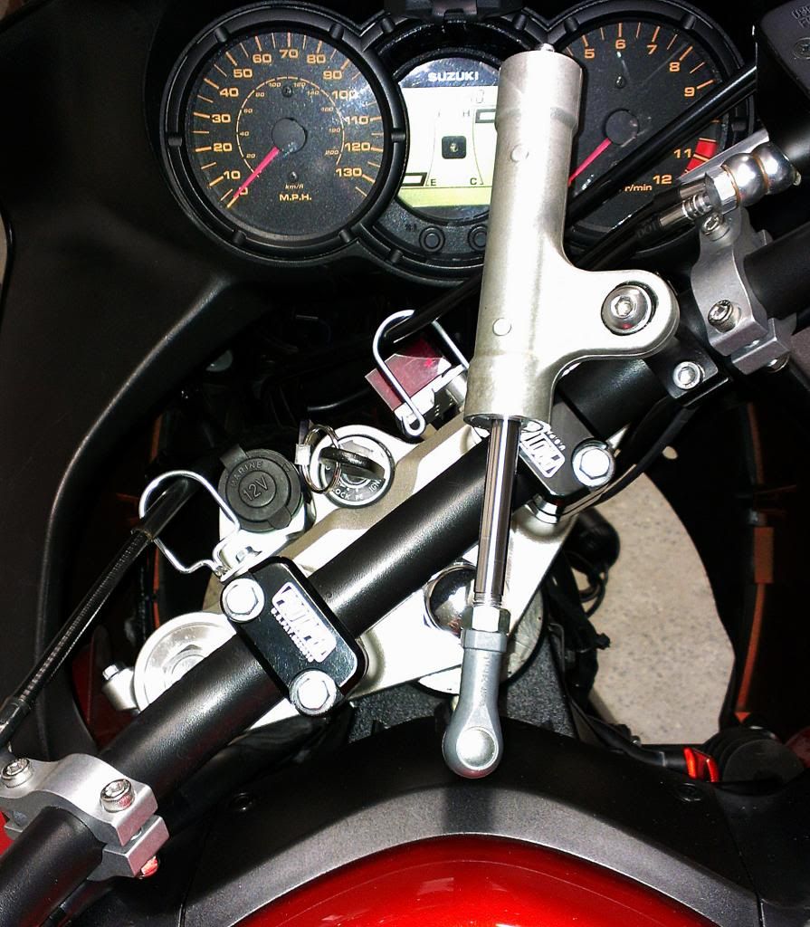

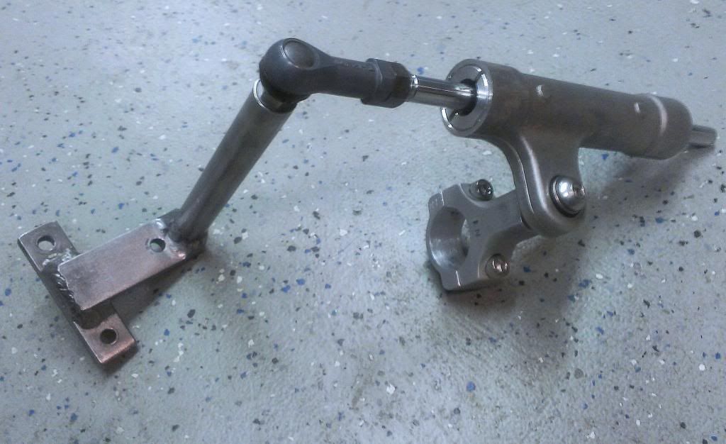

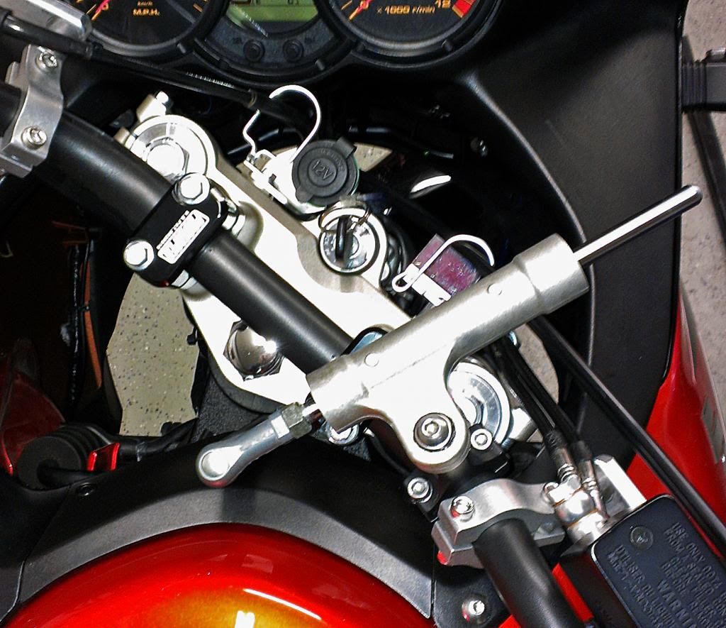

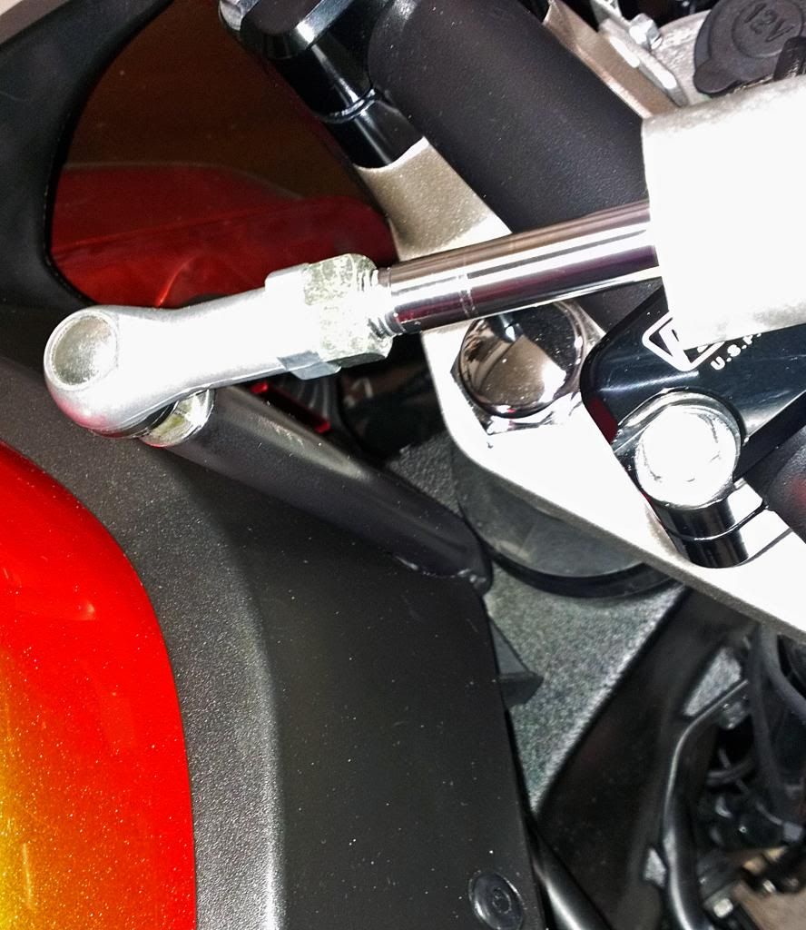

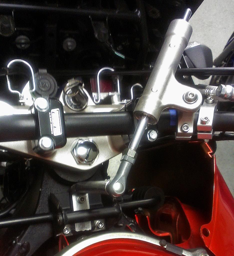

After much thought, I came up with a solution. I welded up a bracket that bolts over the top of the OEM fuel tank bracket. I had to source slightly longer bolts. Note that the clearance for the upright/vertical 1/2" diameter rod is really tight in relation to the top steering bearing cover. I also had to notch out the black plastic fuel tank cover a bit to allow clearance for this vertical rod. I drilled and tapped (8mmx1.25) the top of the vertical rod to accept the damper's rod-end attachment bolt. The damper's center point is joined to the handlebar via a bracket normally used to attach the backbone of a hand-guard. Lots of trial and error was required to determine mounting location while allowing full damper travel and maintain lock-to-lock steering. I also maintained full visibility of the dash/gauges.
The damper works perfectly on the road, alleviating the very slight twitchiness that sometimes but rarely occurs during high speed, high cross-wind and/or heavily loaded with passenger and camping gear. It gives me peace of mind in these circumstances. Vibration of the damper in relation to the engine vibration is not an issue.
