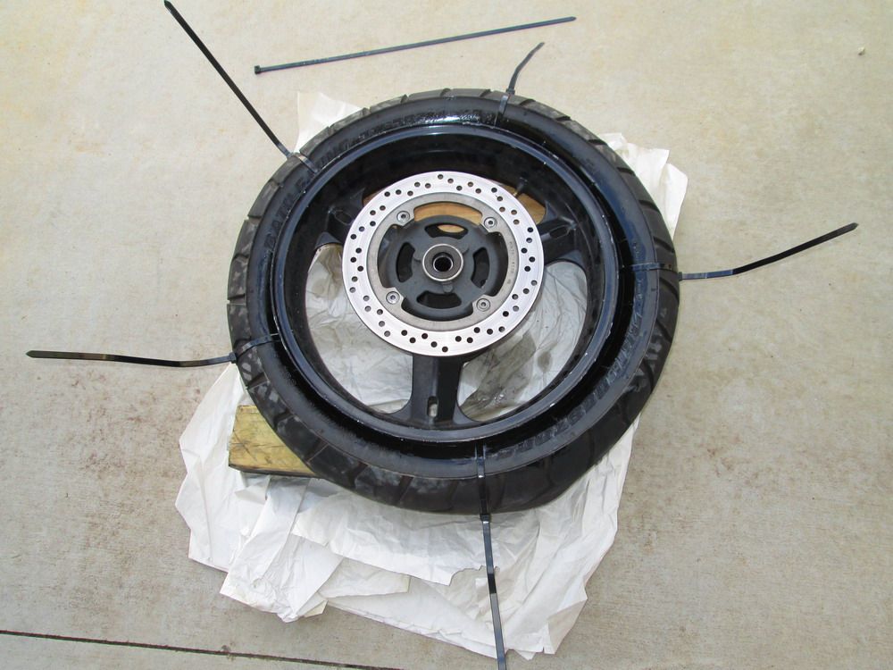

Has anybody here tried using wire ties to help them get both tires beads on or off the rim at the same time? Yesterday I tried to use 24" long wire ties to get a Battlewing 502G off my Wee's rear rim. After 20-25 minutes I gave up, cut the zip ties off and used my tires irons. Another 2-3 minutes the tire was off the rim.
There are many videos on YouTube showing how to get a tire off the rim and also a new tire back on the rim. After my failure to get the tire off the rim using zip ties, I just used my tire irons to spoon a new tire on the rim. Maybe I did not use enough zip ties?

Me and a buddy tried it "did not work", we will not be wasting our time like that ever again. That is my 2 cents.........

Thanks for your feedback. The videos that I had seen on Youtube involved lower profile tires which almost feel off the rim when zip tied. Perhaps our size tires are too "deep". They are not even close to falling off the rim. The inner diameter of the zip tied tires are way smaller than the rim diameter.

FWIW, the accounts I've seen of the zip tie method usually use at least twice that many zip ties.
I can't imagine how it would save any time or effort. If you have any idea at all what you're doing with tire irons, you can have the whole job done long before someone futzing with zip ties will have the tire off.

It looked so easy on Youtube. Garage temps were in the 50 s, stiff walled Heidy. Sure glad I had those tire irons. :furious:

Most of the times I have seen anyone successfully demonstrate the zip tie method I have noticed that it usually happens to be on sportbike tires and usually the rear. My take away is that the wider tire (and wheel), plus softer sidewall probably allows for a lot more flexing and deflection than a typical DS style tire that has a narrow mounting width and stiffer sidewall.
