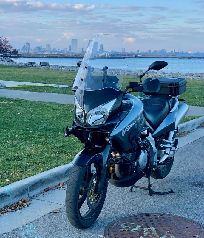

I finally got the correct brackets and was able to install my Madstad windscreen today. Worth every penny!
I still need to do a bit of fine tuning but light years better... no buffeting and much quieter.

I set it to 60 degrees, as recommended, and I set the height so it comes to about my chin. Still playing with it but I'm blown away at the difference. It's so quiet I can hear so much more on the bike. Very happy with my purchase.

I've tried several setups. I really like the stock windscreen with Madstad laid back so it is out of my line of sight. Keeps clean air on my helmet. No issues with visibility, fogging up, tint, etc.
