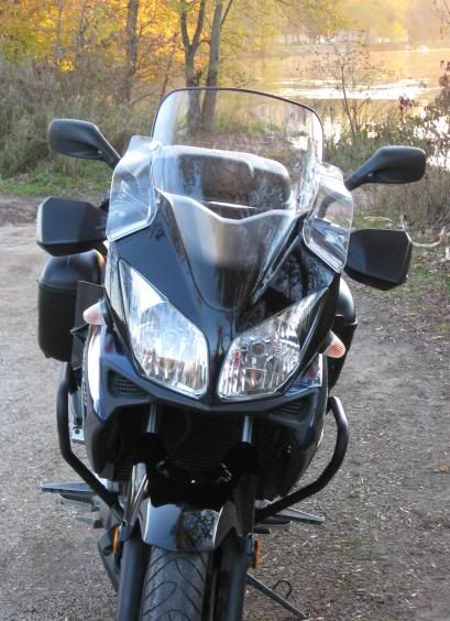

Givi D255ST from Twisted Throttle, now >$100, is 24.5" high, about 8" taller than stock. Sets into the nose like the original, 2 screws.
I'm 5'4" and cut it down 3". The top edge is on a level with my smile so I can look over it to about 25" in front of my Vee. No buffeting.
Narrow coverage lower down, so I added Laminar Ears. Great coverage now.

Nice setup, where did you get those ears? They look like they would work quite well.
