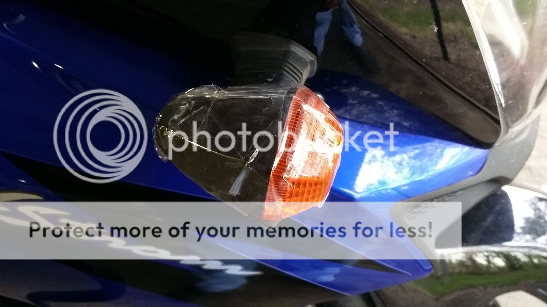

I gently laid my bike down in the driveway while attempting to put it onto a swingarm stand and broke the right turn signal housing. The lens in split into two pieces. The body is in three. I was able to tape it together with packing tape enough to ride. It is functional. From the options in the poll what would you do with it?

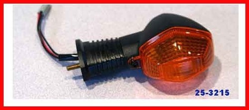

A local friend offered me a signal off this Bandit. I do like the looks and easy install of that Touratech setup.

My buddy had a signal from his Bandit that he gave me. The rubber stalk is different but the plastic head can be unscrewed from the stalk and swapped to my V-Strom stalk. The Bandit has a clear lens with orange bulbs. I'll have to change that over at some point.
I'll have to unscrew my stalk from the fairing and disconnect the wires. Then I'll have to transfer the bulb and wires and stalk to the new signal and bolt it all back up again. Hopefully it isn't too difficult.

The install went well. I had to transfer the light socket from the Wee housing to the Bandit housing because the Bandits wires had been cut. I had wanted to use the Bandits clear cover and orange bulb because of the crack in my orange cover. But an orange bulb has the tangs at 4 and 8 on a clock whereas the clear bulb and socket is at 3 and 9. So I taped my orange cover and used my bulb and socket. It was a bit of a pain to unplug and replug the wires in the small space.
