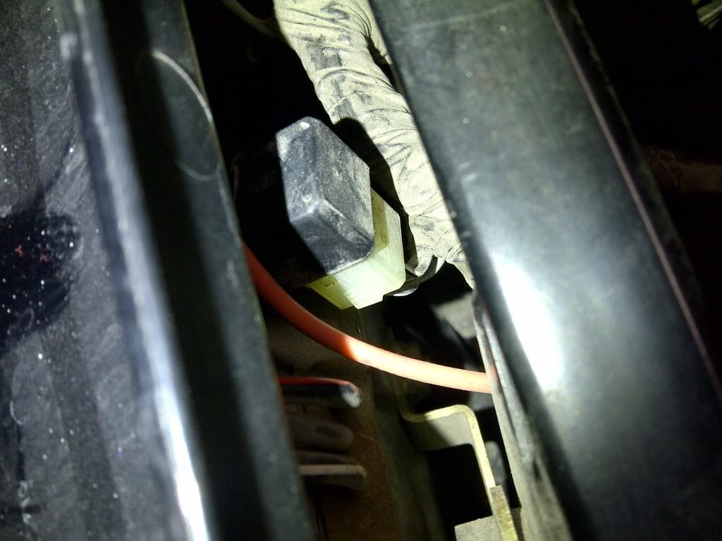

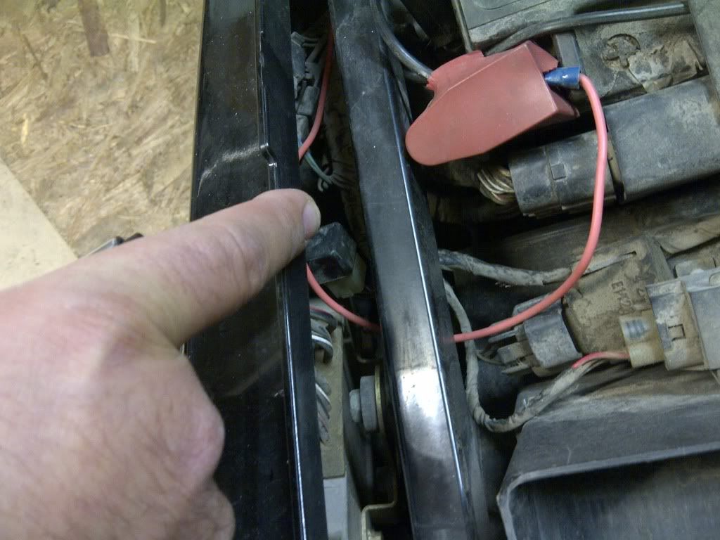

Can anyone tell me what this plug is for? It is located on the left side of the battery. The wires on it seem to all be black with a white stripe.
I'm trying to find the infamous "heated grip plug". I know that it is supposed to be behind the radiator on the left side but I was surprised to find this just dangling there.
Thanks
38,103 Posts
If all the wires are B/W, it's a grounding block for diagnostic purposes. All B/W wires are grounds. The dealer mode plug looks like this. The White/Red & Black/White wires are the ones jumpered to enable dealer mode.
