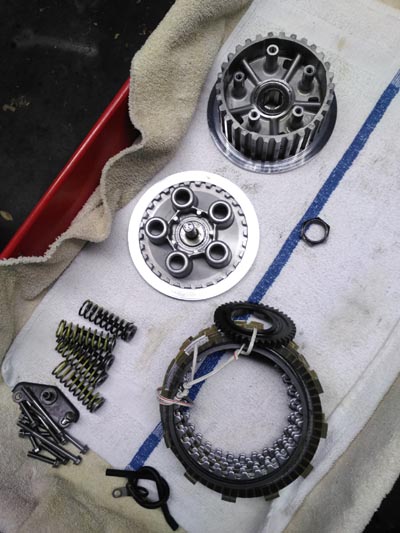

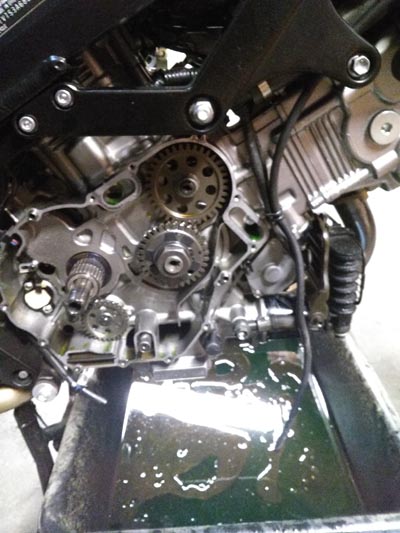

Out with the old.

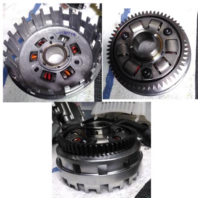

Basket before sending it to WERKS.
Parts ready for reassembly.

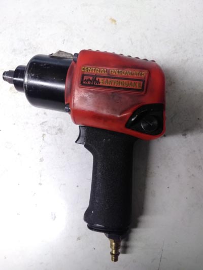

Impact gun makes the removal of the clutch basket easier to remove.
Clutch basket after being reworked at WERKS.
Getting the required 108 ft-lbs of torque.
All back together ready to reinstall the cover.

It was a good thing I sent it in to WERKS because the basket was out of round and out of balance.
