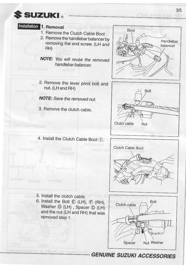

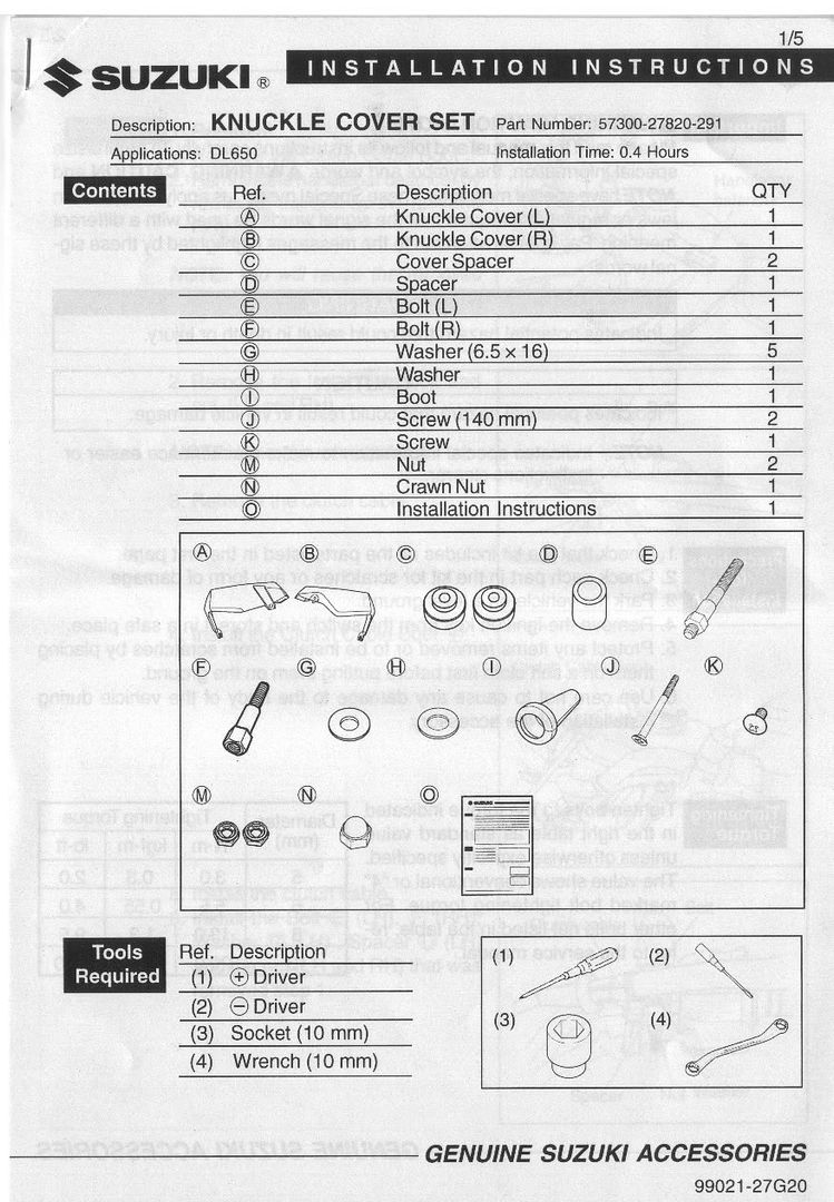

I bought a used set of Suzuki hand guards (never mounted) and the previous owner neglected to send me the installation instructions.
Does anyone have an electronic copy they could send to me? I've already emailed the seller, but would like to have instructions before installing them later tonight.

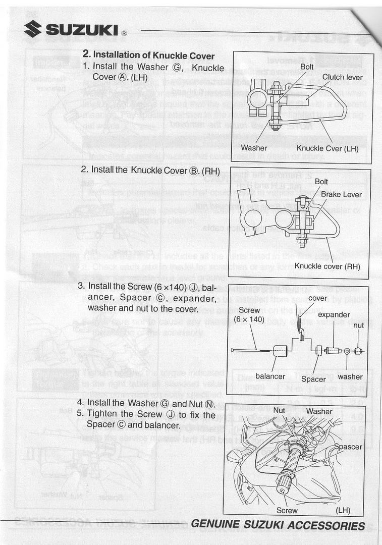

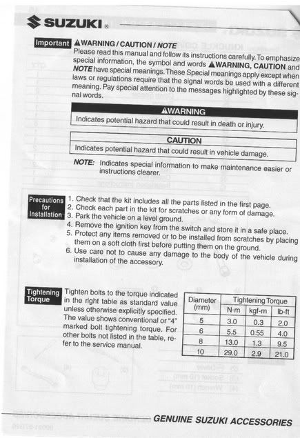

54 Posts
Here it is

I did this installation a week ago, which means it falls about six days outside of my useful memory. However, one thing I remember from reading various posts is that when you first remove your bar end weights DO NOT take the screw all the way out. Just loosen it enough that you can slide the bar end weight out of the handlebar as a complete assembly. Do a few turns of the screwdriver, then pull on the end weight. If it doesn't slide out, repeat. Eventually you'll be able to pull it out easily. This will save you trying to find the nut that falls off the inboard end of the screw if you take the screw all the way out.
It's a relatively painless procedure overall.

gbart951, thank you!!! Between this and the other instructions I got in email... I should have it completely covered!
Thanks!
Bunker, I've already been there with the grip installation. Coming from cruisers, we don't have any bar end weights... so of course I just undid the screw. :lol:
I ended up removing the control housing from the handlebar and then pushing that nut assembly out with an old coat hanger. Definitely falls into the cartegory of PITA. :x

I was able to blow the nut out with air from other end of the bar.
