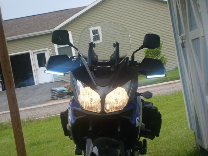

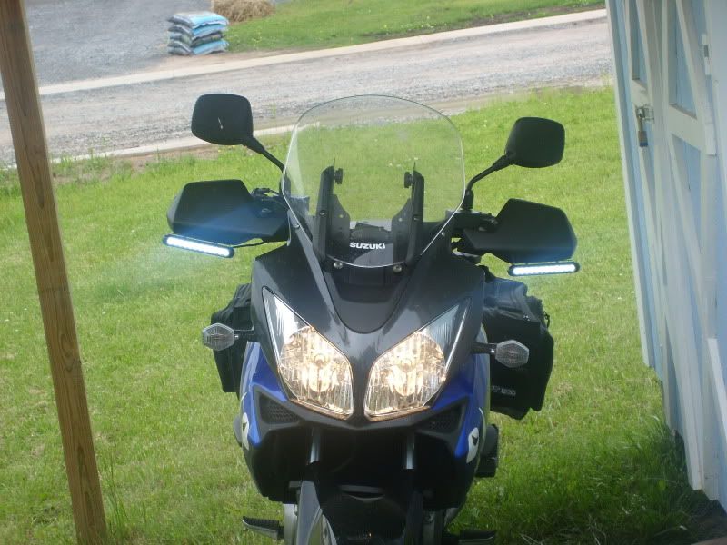

well got my optronics ls-108's mounted/wired up, hooked them into the heated grip socket, had a buddy tweak the aiming while i stood about 30 ft away, here's the day time pics and vid from it, when it gets dark i'll do another set
rode for a short bit behind my buddy and he said it was pretty noticeable
these pics are all from around 15ft infront of the bike
standing height approx 6' from ground
approx 3.5-4' off the ground (around level with headlights)
just a touch above the ground
and finally a vid from standing down to ground level, and back up
i'll take another set at pretty much the same specs after dark

Now your Strom really looks like a transformer!!!!! Anything to help with head-on visibility works for me.

I like the way those look.

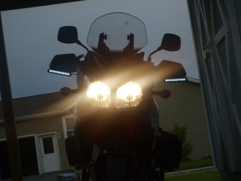

ok, here's the nighttime pics
here's just the leds (covered up the headlights with fleece vest) at side of my house from about 15 feet away)
standing height (6' or so)
the majority of these next pics were on a tripod setup about headlevel for me in my passat so average cager eye level? at increasing distances away
the lights even throw a lil light onto the dash, in real life its not quite as much as shows in the pic due to the slightly lengthy exposure but theres definitely light
and finally, vid from various distances/angles

Cool light show. Also adds to the width of the bike for cagers to notice. Well done.

haven't had a chance to ride with anyone in a cage yet to get impressions, had a couple cops at an intersection double take at me while they were directing traffic

rode with a buddy again teh other day and he said even with the low setting sun behind me (he was riding lead) he could still see the lights and they were very noticeable
and apparently when i pulled into the driveway his wife thought it looked really cool :cool:
