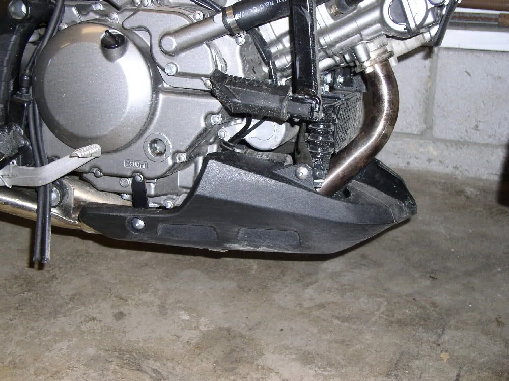

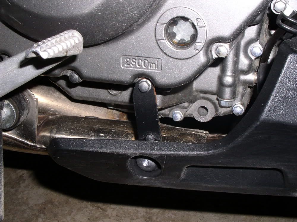

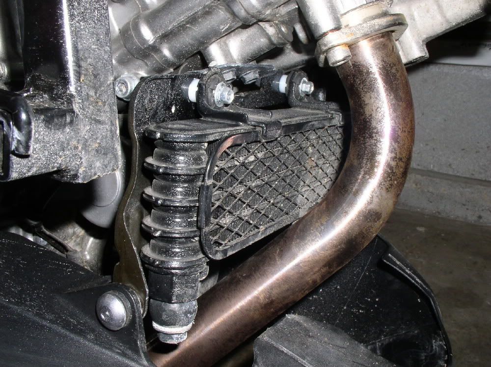

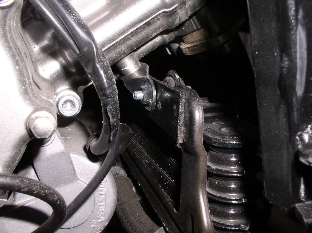

Winter always allows for some time to mod and come up with ideas. Everyone kept saying the 1000 belly pan wouldn't fit the 650, and for the most part that is correct if you want it to bolt up right out of the box. But with about an 1 1/2 of fabbing we were done and it looks great. Modification of all three brackets must be made, but was not very difficult. A small amount of trimming of the pan around the header pipe. I think it turned out great and I love the filled in look.

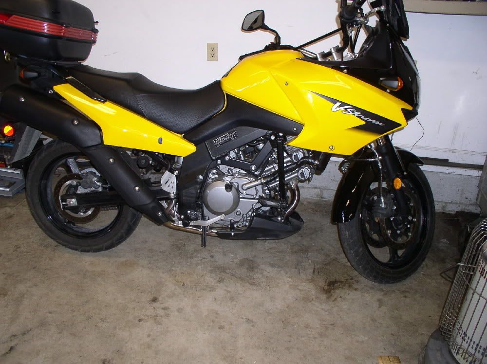

Nice mod! Tell me more about those highway pegs though.
137 Posts
They are just 1x1 square tubing wielded to some flat stock. We used the footpegs and peg mounts off of the passenger peg brackets. My wife won't ride a bike so no big loss of pegs. But I won't be able to use these with the crash bars I am going to put on, so they may be up for sale soon. Very sturdy and makes for comfort to stretch out the legs some.

From what I can see, I honestly do not believe I will have to remove it to get the oil filter off.

It was NOS, but got it fairly cheap. I had seen some of the ones specific for the wee, but decided to just work with what I already had.
