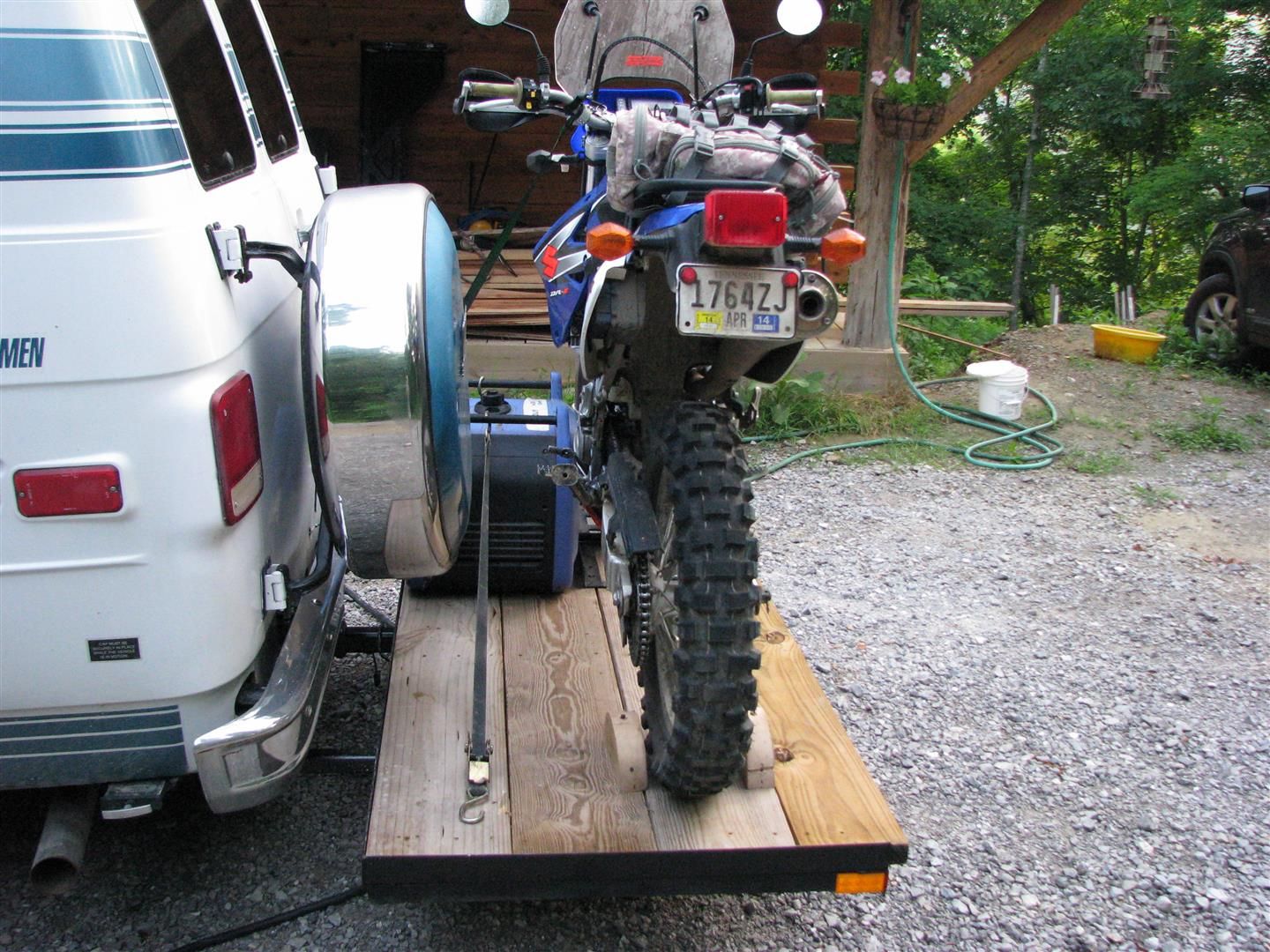

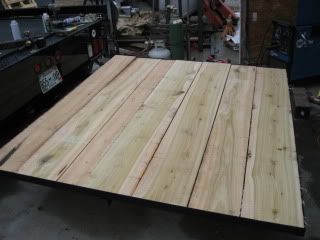

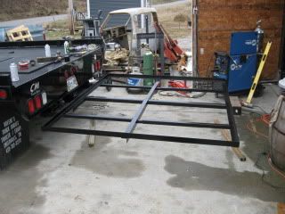

I ditched the single bike trailer and built my own hitch hauler:
I put reflectors and led lights on it. Any class 3 hitch can handle 500+ lbs easy.

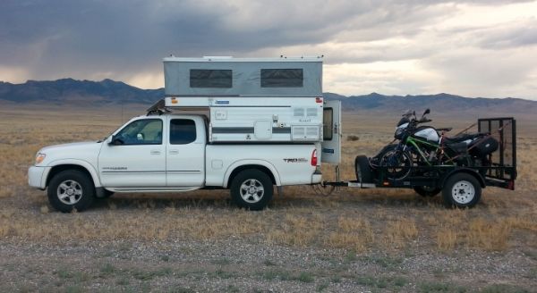

Hitch haulers are okay for short distances on smooth roads. Unless they are over engineered they can crack. I have put many thousands of miles on different hitch haulers and both developed cracks. I'm talking coast to coast. I now use a utility trailer and also throw on my bicycle and other items. Everything is a compromise. A trailer is a pain at times but it does the job well. Anyway it is what I found works for me.

I like you set up....This was was my all time best camping rig until the wife decided she wanted a van camper:headbang:
I used a 7 wide x 6' long hitch hauler on my truck camper that I built...and I consider myself a novice welder. I hauled a 25Kw PTO generator from Minneapolis to TN on it with no issues. The weight of the genset and it's trailer were about 500 lbs.....Minnesota interstates absolutely suck especially in winter. The same hitch hauler went to Manitoba and back twice with a DRZ on it.
You are right, small gauge tubing and only one point attachment(mine had three) to the truck frame is a hauler that should never carry over 100lbs.
