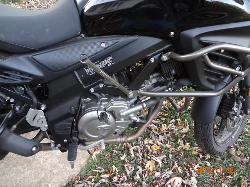

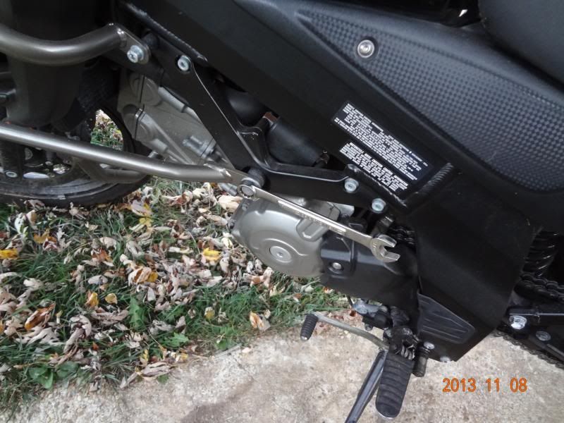

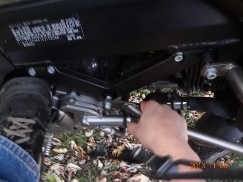

So start by removing the long bolt that goes through the frame and holds the upper engine mount in place:
The Frame Slider kit comes with a long threaded rod to replace this bolt. Slide it in.
Two washers on each side and one large spacer on each side will fall out. You should end up with one long bolt, four washers, two spacers, and a nylon locknut.
Set it aside if you ever want to return to stock.

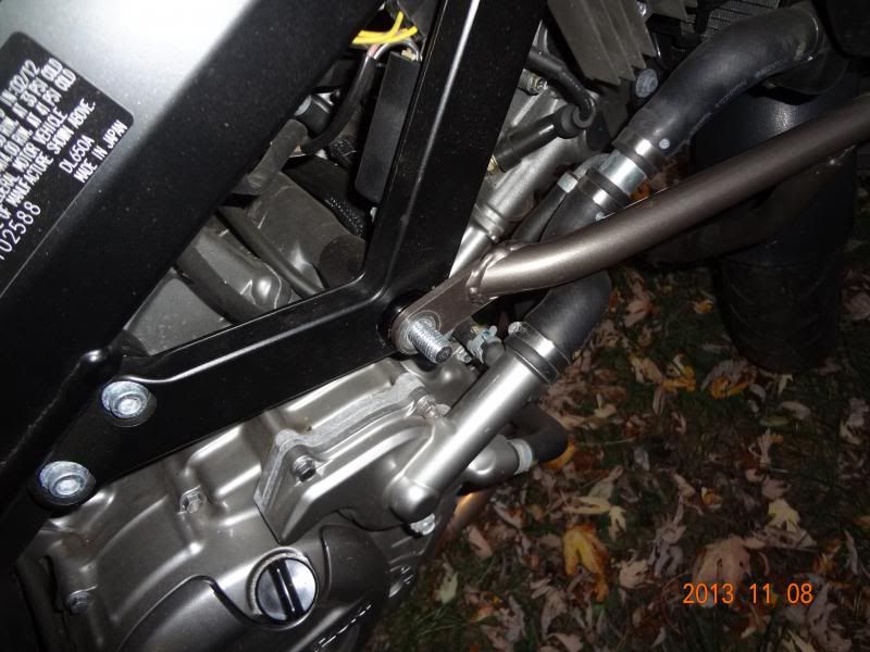

Loosen up your upper crash bar mounting. You do not need to remove these bolts entirely. Just loosen them about 3/4 of an inch should do.
You should be able to pull on the crash bars to get them away from the bike. You can use your foot to push against the frame or engine for some leverage, but the bars should have plenty of give.

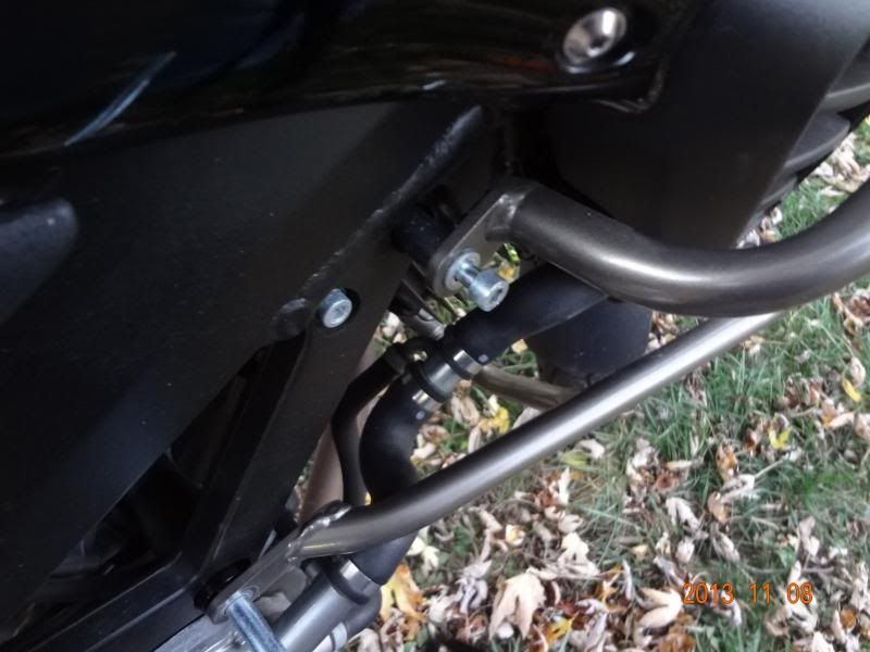

The Frame Slider kit will have two new spacers and one washer to install. It is important to note that there are two different spacers for left and right. The larger of the two goes on the left side. The one large washer also only goes on the left side.
This section of the included instructions goes as follows:
"The smaller spacer goes on the right side and the larger spacer goes on the left side, with the Single Large Washer included going between it and the special Suzuki engine bolt."
This part confused me because I thought I took out the Suzuki bolt at first.
This really means the engine mount that is inside the frame.
http://www.stromtrooper.com/sv-raci...slider-install-confusion-photos-included.html
Put the washer in up against the engine mount inside the frame and then the spacer goes in next. Install the large spacer and washer like so:

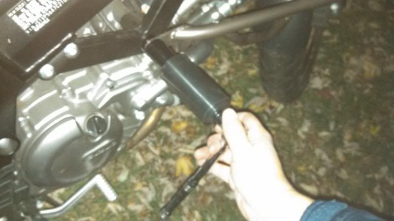

Center up the long threaded rod left to right:

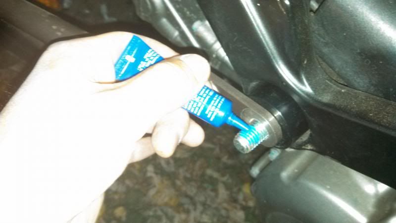

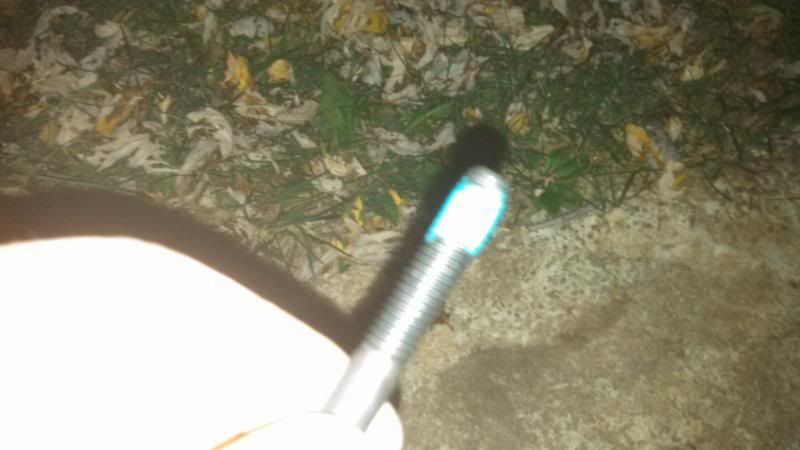

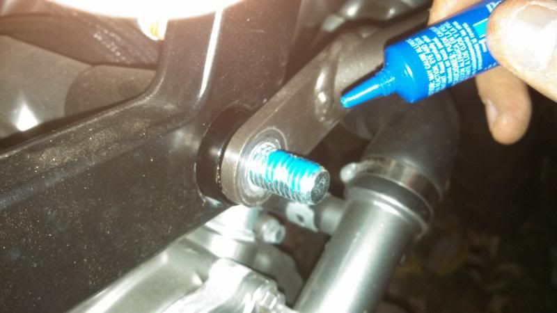

Apply BLUE threadlocker to one side. I have red threadlocker in a blue tube. It's very confusing. I would have needed a torch to remove these if I used the red.

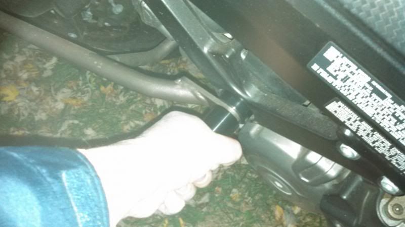

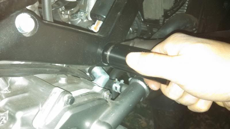

Hand tighten one of the aluminum support posts for the Frame Sliders.
Apply BLUE threadlocker to the other side.
Hand tighten the other aluminum support post.

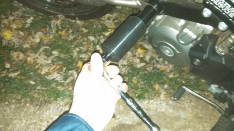

Use wrenches to snug the two aluminum support posts. (Very hard to manipulate two wrenches while taking a pic.)
Pay attention to the directions. They say not to "Go gorilla" on it.
Too tight and you'll bend part of the frame. You may also crush the engine mount and introduce vibrations from the engine into the frame. Half to one full turn after hand tight should be good.

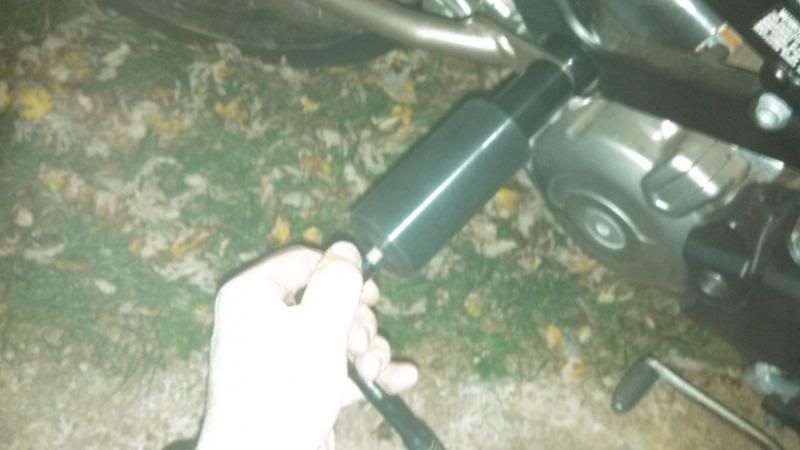

Add threadlocker to the allen headed bolts and install the plastic end pieces.

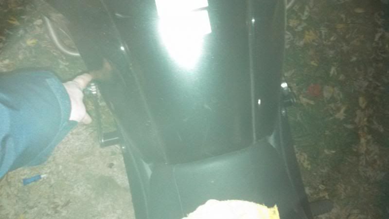

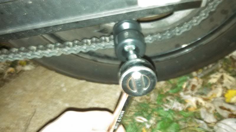

Finally, if you got the swingarm sliders, they go where the race stand pegs go. (Don't forget the threadlocker.)
