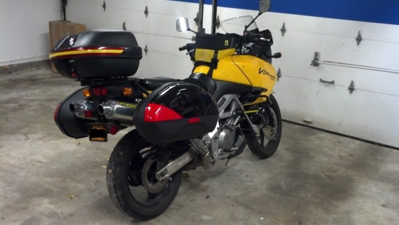

I just mounted the 650 part number on my 1000. The spacer for the left footpeg mount was too short. I happened to have another spacer that worked perfectly. I have Two Brothers pipes that have tons of clearance with both racks. Can't speak to stock pipes. I liked the design of the new top rack and it was easier to secure my topcase plate. The hardest part of the install was forcing in the stupid rubber bumpers.
73 Posts
Here are the specific part numbers that I used on my 2003 DL1000:
990D0-27G00-066 Side Mounts
990D0-06G00-061 Top Mount
990D0-27G01-YAY luggage bags
I bought them because I got a great deal on Ebay of $525 for everything brand new from a Suzuki dealer. My Wolfman Expedition Seat bag fit perfectly with the slope of the OEM side cases. Its nice that you can still see the pipes.
Here is a picture of the finished work:
