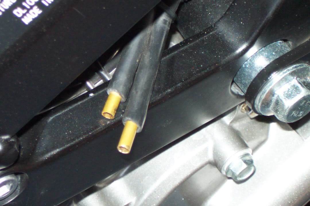

We also hooked up the vac tubing extensions so future TBS-ing will be an absolute breeze. I fogot to take pics of those.

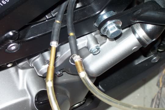

Here's pics:
Just did another TBS (7k mi later) and off 4" of mercury. These extensions ROCK!!
