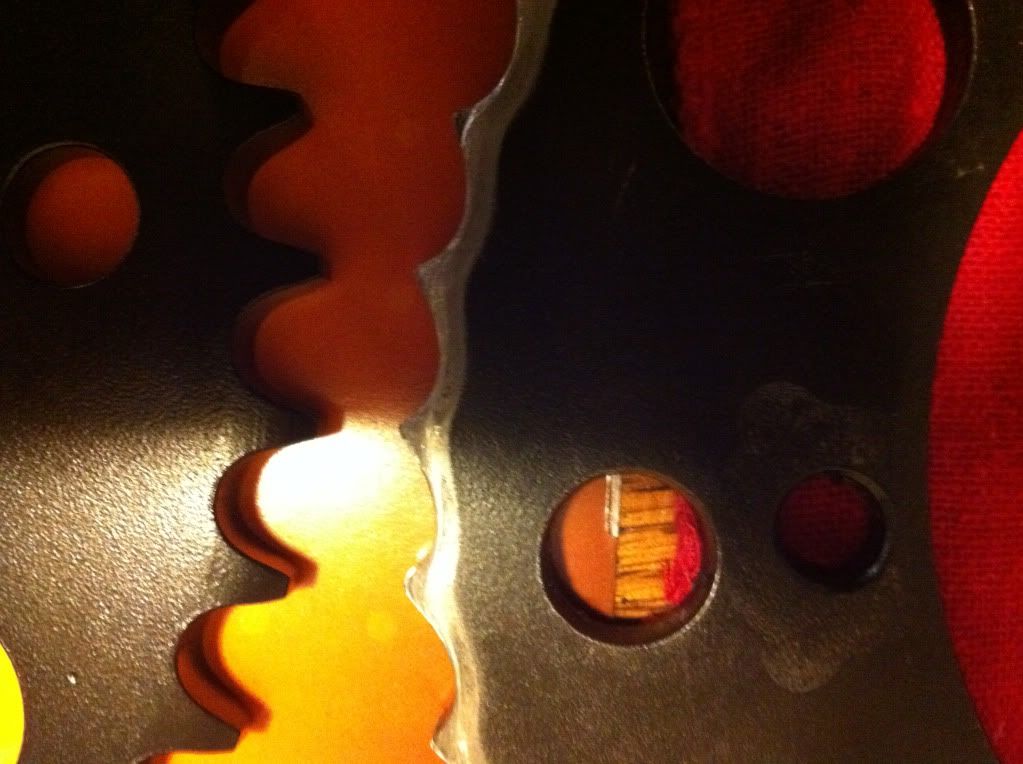

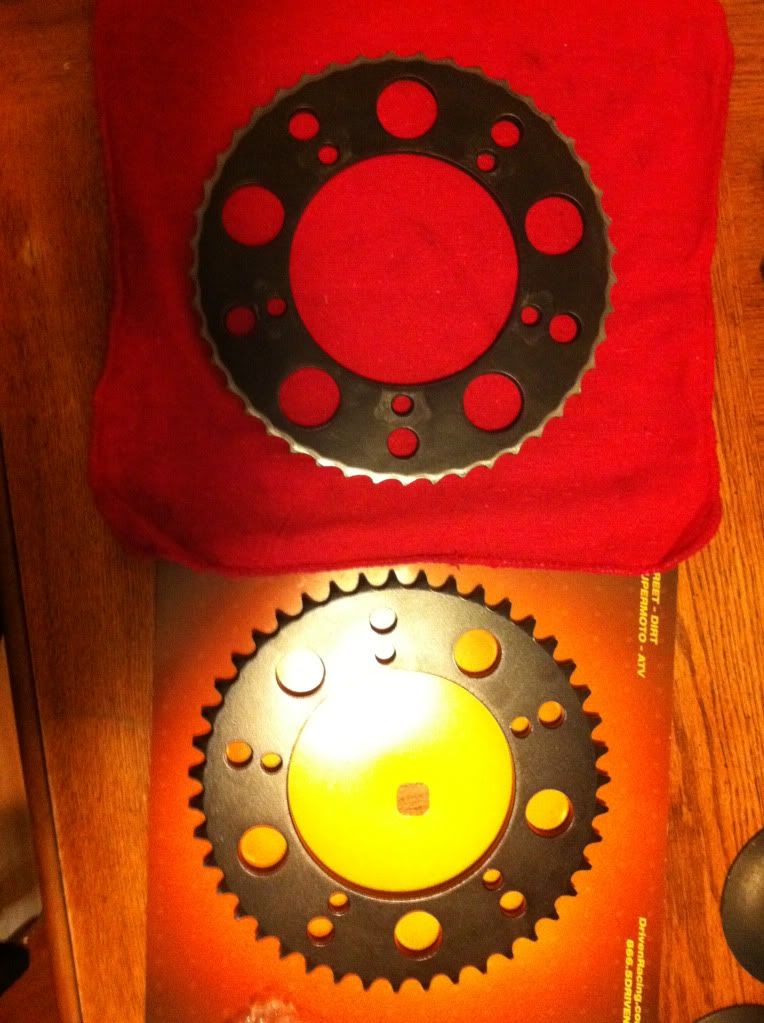

Not that long ago, someone suggested turning your sprocket around could extend it's life, my comment was, when I am done with a sprocket, turning it around would be pointless...
Here is my rendition of Time for a new Sprocket.
:yikes:
this is what I call getting your money's worth.....:beatnik:

Oh and Props again to Blair, got the new one Monday thanks!!!

How many miles did you get out of the old sprocket shown????????
This sprocket is a 530 / 45 and it has about 45,000 km's on it. I do not get great life out of my chains due to the fact I ride in snow, salt, rain, mud, dirt, and rocks..... but it is half as much again as I was getting from the 525 Chains...
In fairness, when I switched to the 45 tooth rear, the adjustment started just back of the mid point, as the chain wore, I ran out of adjustment space. The cold made me put off in Dec, removing a link and sliding the wheel forward.
There was way to much slack, and I spun the chain, if I had corrected the adjustment space earlier, there is a good chance I would have got more life out of it...

Yikes!
I have had a chain pop off my rear sprocket before...scary experience. I can't imagine running that sprocket in that condition.

Man, it looks like you got just about all the good out of that one:)
