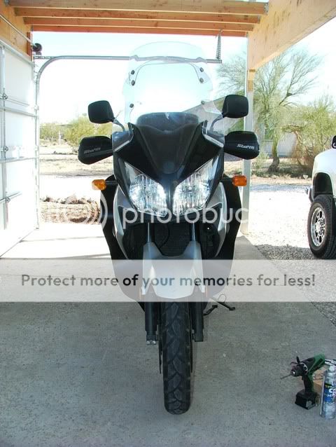

I decided that for me to be suitably comfortable on winter morning commutes, was to get a set of leg fairings for the Strom.
This would prevent the numb toes and frozen chicken tenders.
While searching through the available brands and models, I settled on the Schwings by Kludgemeister.
Impeccable German Engineering, lithe Italian styling, expertly applied veneers.
Kludgemeister Schwings are unencumbered by these expensive constraints.
They are, in fact, just scissor-cut sheets from a roll of thirty year old fiberglass.
Amazingly, they work super well. Tested on the Interstate, I found them to do exactly as hoped, directing the air from around the entire leg and foot. There was no fluttering or noise. Although they weigh only a few ounces each, they are strengthened by their inherent S-shape. Following closely behind a large salt-water fishing boat at 90 mph (think about it), even strong turbulence did not negatively affect the Schwings.
Here is a step by step install.
Step One: Hold a yardstick close to your pants and take a measurement.
Step Two: Use the Kludgemeister templates you previously made, to layout the pattern on the fiberglass sheet your elderly father donated.
Step Two Again: Rotate 90 degrees and repeat.
Step Three: Use the provided laser extractor to free the Schwings from the mold.
Step Four: locate the Kludgemeister armored attachment resource. Using the laser extractor again, follow the dotted lines in your mind, releasing the finely crafted brackets.
Step Five: Trial fit the brackets to the Suzuki Leg Fairing Mounts.
1) Tank fairing upper side mount
2) Funky black t-thing on the side of the bike forward mount
3) Radiator hose (right side on U.S. bikes. All other models use the right side.)
4) Nose fairing mount
5) Screw directly to the nose fairing, cuz you ran out hacksaw blades.
Step Six: On certain years of the V-Strom (2003 to 2012) it may be necessary to trim any access flangular meganisiums from the Schwings.
Step Seven: after trail fit, remove the Schwings for sanding and application of the double-sided polymer-glucicides. I used satin black automotive trim paint, as it bonds well to flexible thingies. Also, I had a can already.
As you can see, from the side the Schwings blend right in to the lines of the bike. Kludgemeister engineers originally intended this to occur, however, during the manufacturing process, they found that by allowing the Suzuki attachment points to dictate the bends of the Schwings, it might actually work.
Step Eight: Ignore that look on your wifes face. She is just being practical.

Discussion Starter · #11 ·
Or get a pair of wind/rainproof overpants. Which can go on or come off in a jiffy as needed, especially here in up-and-down land.
But I admire your creativity.
During the colder weather, I snap the water-wind proof liners into my ATGATT overpants. They do help some, but they have two drawbacks.
After a half-hour of 80 mph at 35 degrees, the cold just beats its way through. Then on the same day, in the Arizona winter afternoon of 78 degrees, I get home and I have sweat through my slacks. Ew. Too hot.
Honestly, I am surprised that I haven't moved up to a Goldwing or ST1000.
But I like the Strom so much, this is the longest I have ever owned the same bike.

Discussion Starter · #16 ·
- they are ugly as hell..let me know if they work- they look practical..kinda like the fairing lowers that bmw/gold wing/ hd touring bikes have as accessories
First real test of the completed Schwings.
Temp this morning was 46 degrees with a light wind.
Long commute on the freeway - legs and feet stayed warm, hips getting a little more blast than before but not uncomfortable. Chicken Tenders cool but not freezing. Engine temp stayed at two bars (typical for winter morning).
Upon arrival at office, pulling off the gear, I found that I had begun to sweat under the water-proof liners of my overpants. I will try tomorrow without the liners to see if I stay warm enough at speed.
Could definitely feel the wind resistance against the Schwings. Though it seems to stabilize the bike even more. Wind-blast from trucks and RVs is felt to be pushing on the bike more and me less.

Interesting, thanks for the feedback. I can see lots of opportunities for development..for example- try angling them backwards slightly, making them smaller/larger...Who knows-maybe the idea will be picked up by givi to make "touring lowers" ..patent the idea fast.
I wear Tourmaster Flex pants & jacket and find that combination adequate, but I admire the thought you put into it..
