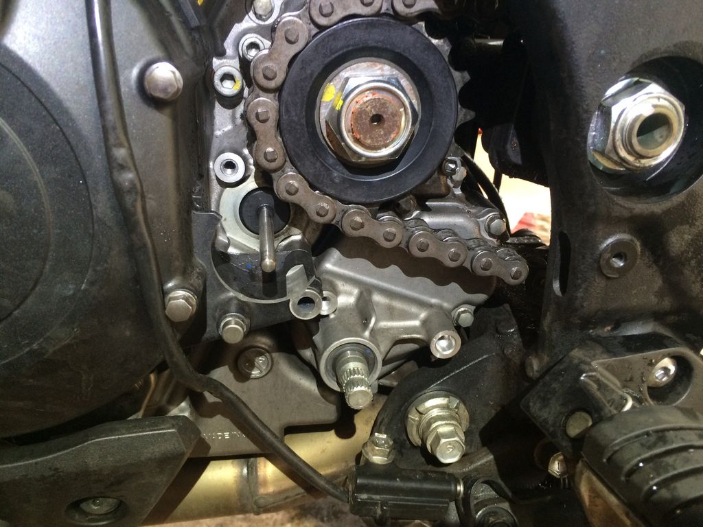

I agree with those who say give the thing a periodic clean and maybe use less chain lube, however I'm guilty of having not checked mine since the bike was new 16,000 kms ago :serious: I do a reasonable amount of dirt riding and have done a lot of very wet road riding since the Monsoon kicked in here in Darwin.
So I thought I'd go take a look.
The following might provide some clearer idea as to what the OP was talking about. I can see both points of view (clean more regularly versus provide some added protection).
This is the offending area after slave cylinder and plastic cover removed and I'd cleaned it up.

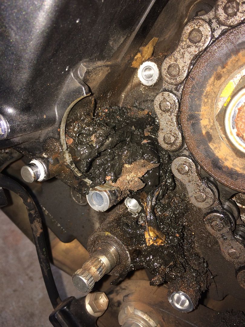

This is what I found when removing the plastic cover after first removing the slave cylinder.

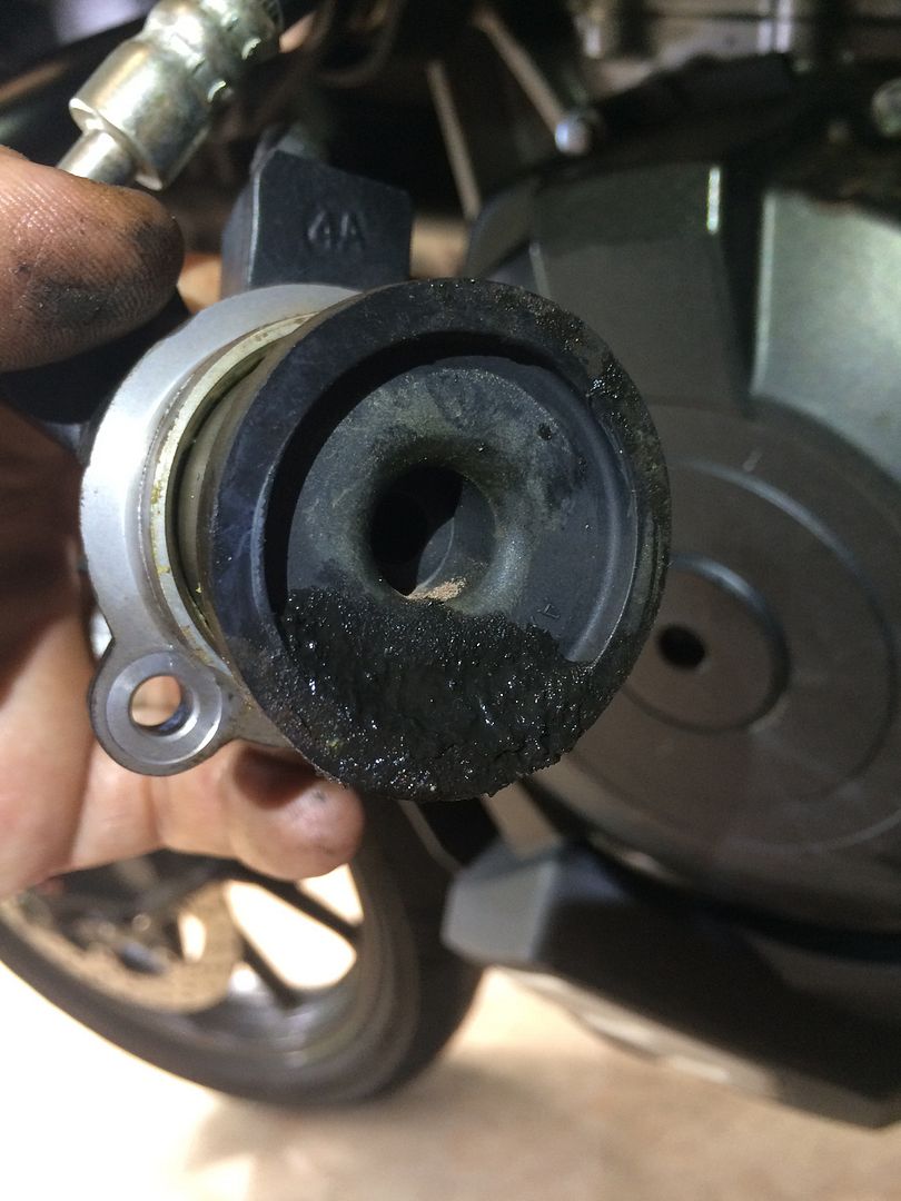

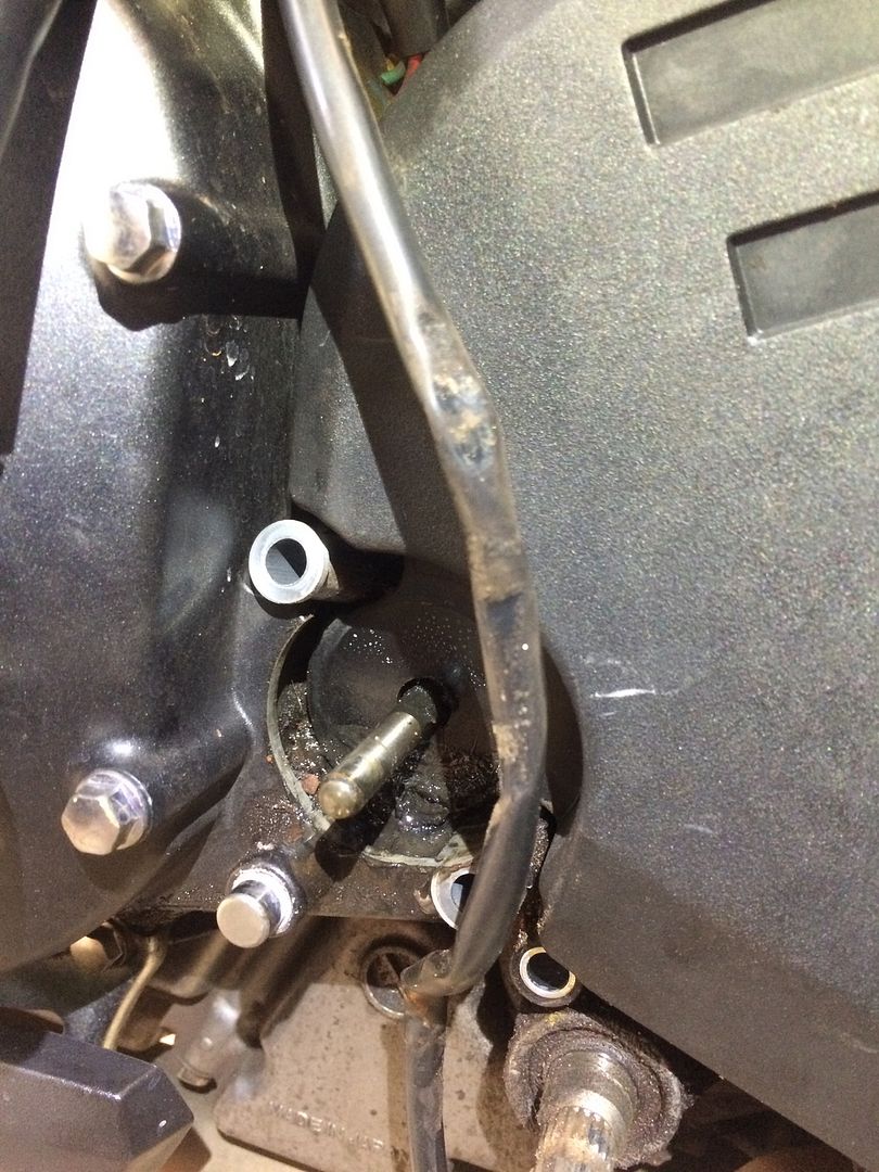

The photo below is with just the slave cylinder removed. The plastic cover hides most of the crud behind it.
Photo below shows the inner rubber diaphragm seal on the slave cylinder. You can see it's been doing its job keeping the crud away from the slave cyclinder piston.

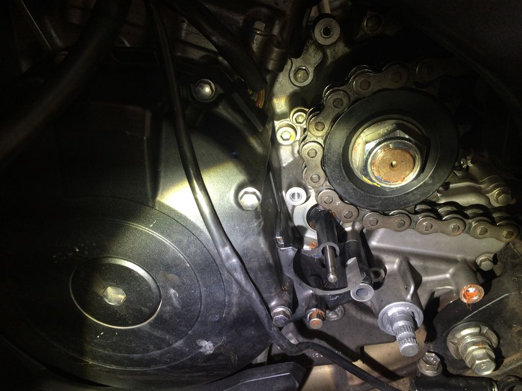

And the image below shows the 8mm I.D rubber tube I've used to provide the shaft a little more protection as the OP had suggested might be useful. I agree that under the circumstances, it certainly can't hurt.
Hope this assists those who were wondering.
