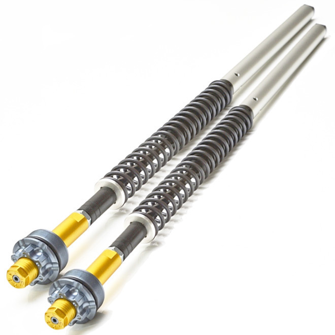

Overall, you will be able to improve the DL650's fork action, but don't get your expectations too high. To get the fork performance into the 2000s, you'll need to pop for a cartridge kit such as a Traxxion or Andreani.
Good luck with it all and hope this helps.
I have never heard of cartridge fork kits, so I Googled the brands that you listed.
