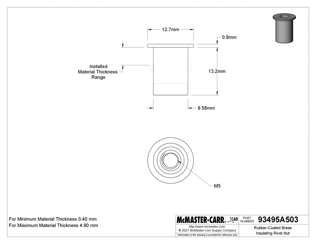

A well nut is the same no matter what bike it’s on. Unscrew the screw from the well nut until only a thread or two are left engaged, then carefully pull the well nut out. It bulges on the end to hold it when the screw is tightened.

Once you have loosened, but not completely removed the screw, you should be able to wiggle it out. The idea is that they expand as they tighten.

Shiiiiiit, warm it up, cut the lip, push it through, done.

McMaster Carr
The size of the well nut is based on the bolt that threads into it. What is the diameter of the bolts removed? A 5 mm well nut will have an OD about 9.5 mm in diameter, but it is still a 5 mm well nut.
If you removed a 5 mm bolt from the wind screen you probably have the correct well nut. Just pull it out after removing the bolt.
