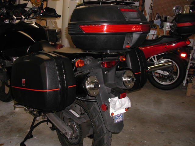

Getting the cap right was the hardest part
...It's not perfect (remember the obsessive-compulsive statement?), but at a distance it looks like a true dual setup and will carry my tool pouch, rags, etc...
Looks very good to me. This has been my plan as well and I recently acquired the required exhaust to do it. I'm curious how your cap attaches to the tube. Can't figure it out from your photo above.
