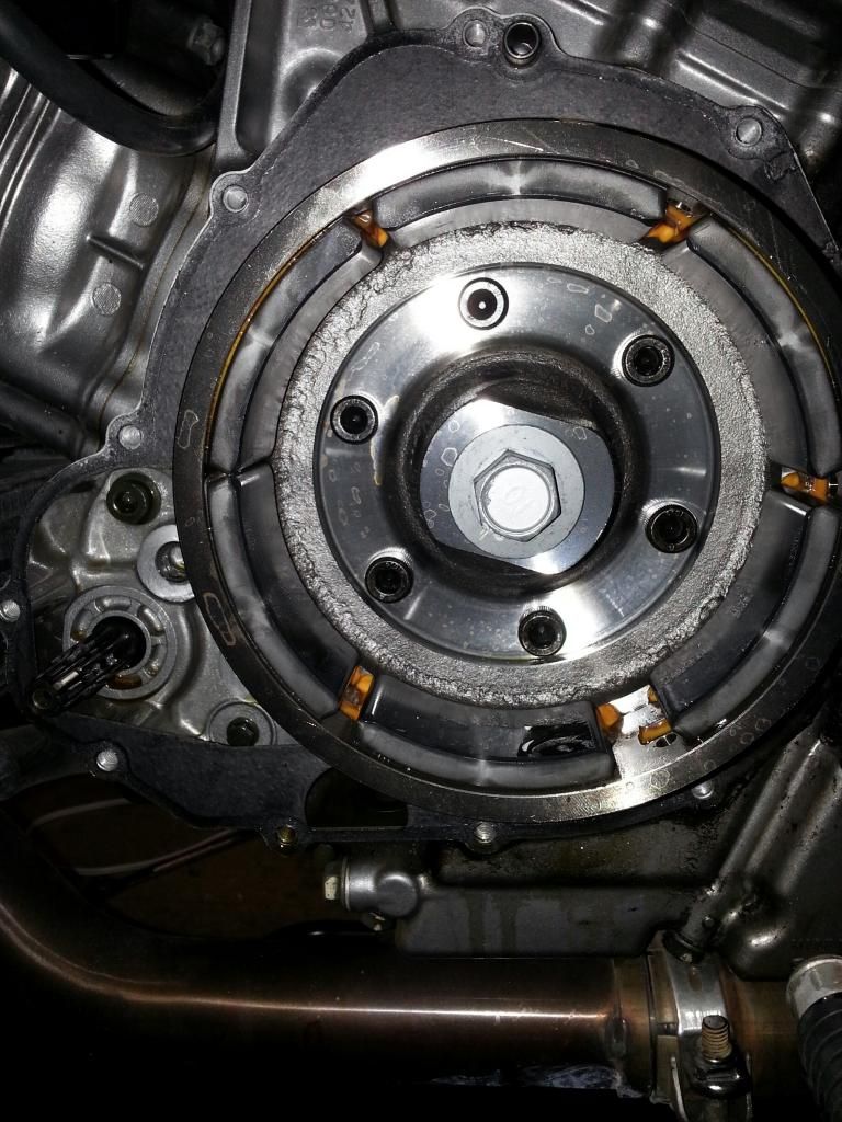

I have a 2006 1000 with 71,000 miles and recently have had intermintent charging problems, the rotor magnets have moved and some are broken. I ordered a new rotor and stator just to make sure everything is good. Should I JB weld the magnets on the new rotor before it is installed? or has Suzuki used a better adhesive on the new one?

Tore my '06 1000 with 36K miles apart today to inspect the mag's and stator.
All looks good for me but went on and did some preventative JB Weld around the mags to make sure they don't move.

So did you just add some JB Weld along each side of the magnets?

Add me to the list with a 2003 with 32k miles. My bike was charging fine, 14.5 at idle. I took a peek because I'm taking a long trip and didn't want this to catch me on the road.
Will be doing the JB weld fix. What do I do with magnets that have not come loose? Just leave them or try to carefully remove them? I guess if they haven't come off in 11 years, they'll probably stay put.
If they don't come loose, don't force them. They are fragile. A little JBWeld on the edges where it won't hit anything should make sure they stay put.

One more 03v added on the loose magnet poll. I JB welded them back in and it went from charging about 13.3(before) to 14.5 at the battery posts at idle. The stator and r/r checked out good. It has about 22000 miles on it. It seemed to be running a lot smoother and quieter when I took it for a spin this evening but that may have been the cool night air. ALSO--I didn't have a compass to check the polarity but I laid them out in the order they were in and I noticed that the ends were attracting one another but if you turned them around, they were pushing away..... Is that an accurate way to make sure you have them turned right?
