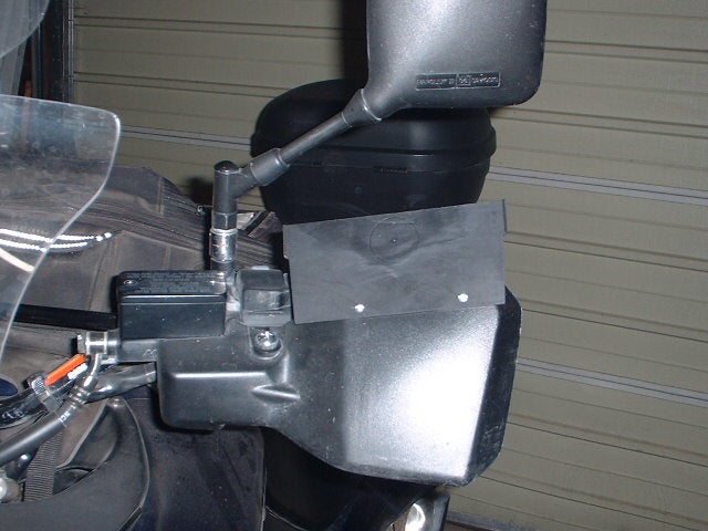

The Vee has a hydraulic clutch and the Wee has a cable clutch. The attachment points for the left hand guard are totally different. See if the left side on yours looks like mine. Of course, yours won't have the hand grip heat controller knob on it.
The DL1000 left side looks like this if you ignore the added on flap.

The Vee OEM handguards are the best choice for the Wee. There are other Strom handguards for sale for the Wee that don't connect to both sides of the bar and don't offer as much coverage. Your guards should look like the ones below.

It looks a lot like the Vee handguard in the picture, but the fastening screw/bolt is in a slight grove, rather than on a flat plain. I noticed the hole the clutch cable goes through have been enlarged (at least I think so, because it doesn't look like a factory finish)

The groove is present on the DL650 guard only. I've never before heard of anybody getting a DL1000 left guard onto a DL650 and it appears I still haven't.
