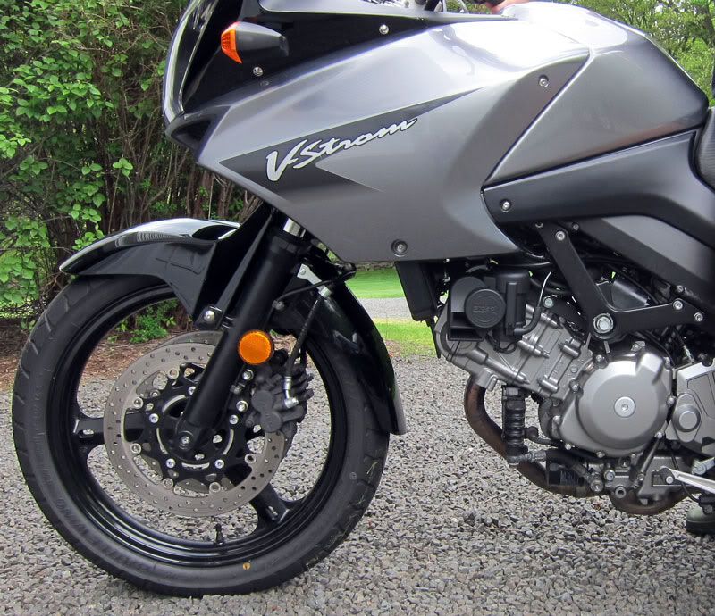

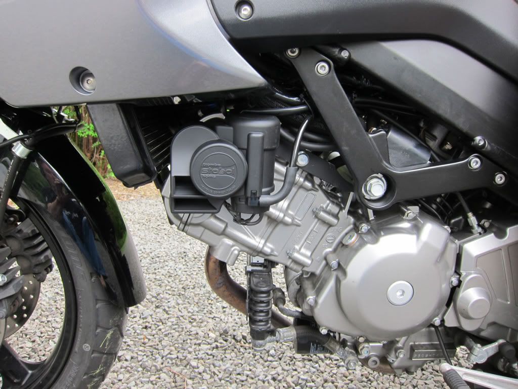

I don't like to overdo it with farkles and really keep to the "essentials". This year I got a new seat and tires and kind of got that "new bike" feeling, so I decided to add a Stebel for a project. After doing a little research, I decided to go with the Pat Walsh Designs Stebel Horn Kit for V-Strom DL650
They are currently giving free upgrades to the new BackMax horn and that is what I got. Gary there was very helpful and service was excellent.

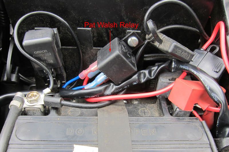

Installation was easy. It takes a little while as most wiring projects do, but it isn't difficult. I did an extra step of spray painting the mounting bar flat black for a nicer look. As shipped, it is silver.
Note from the pictures, I bolted the relay to a plastic tab which requires drilling a small hole. The wiring is a little messy, but the picture was taken before I tidied up.
Bottom line - excellent vendor, nice product and the black looks very cool. Horn volume is loud. Would have preferred it to point toward the front instead of the side, but as is it makes for a good mounting situation.
3,179 Posts
wow - that looks way better than I thought it would [I have the PWD mount and original metal colored model]. Looks like there's now a black plastic cover over the original's metal/silver housing - very nice indeed.
