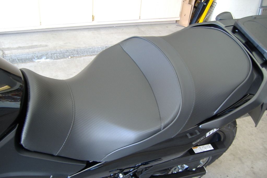

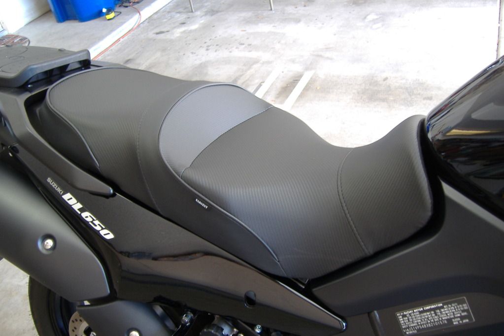

Okay, first and formost for me a new Sargent seat. Huge improvement over stock! Looks great, feels great, fits great. Ordered from Rocky Mountain ATV, got it two days after placing order! Well packed, arrived in perfect condition. Very happy with the seat and Rocky Mountain ATV

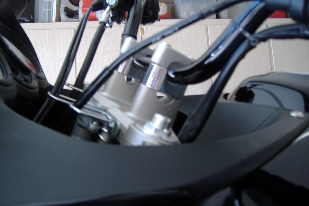

Next up on the comfort agenda was a set of bar risers. I ordered a cheap set of 1" risers for $28 bucks on EBAY. I really like the comfort. combined with the Sargent seat, a huge difference in position and comfort.
however you get what you pay for, I dont like the looks(see picture) I will probably change them out in the future.

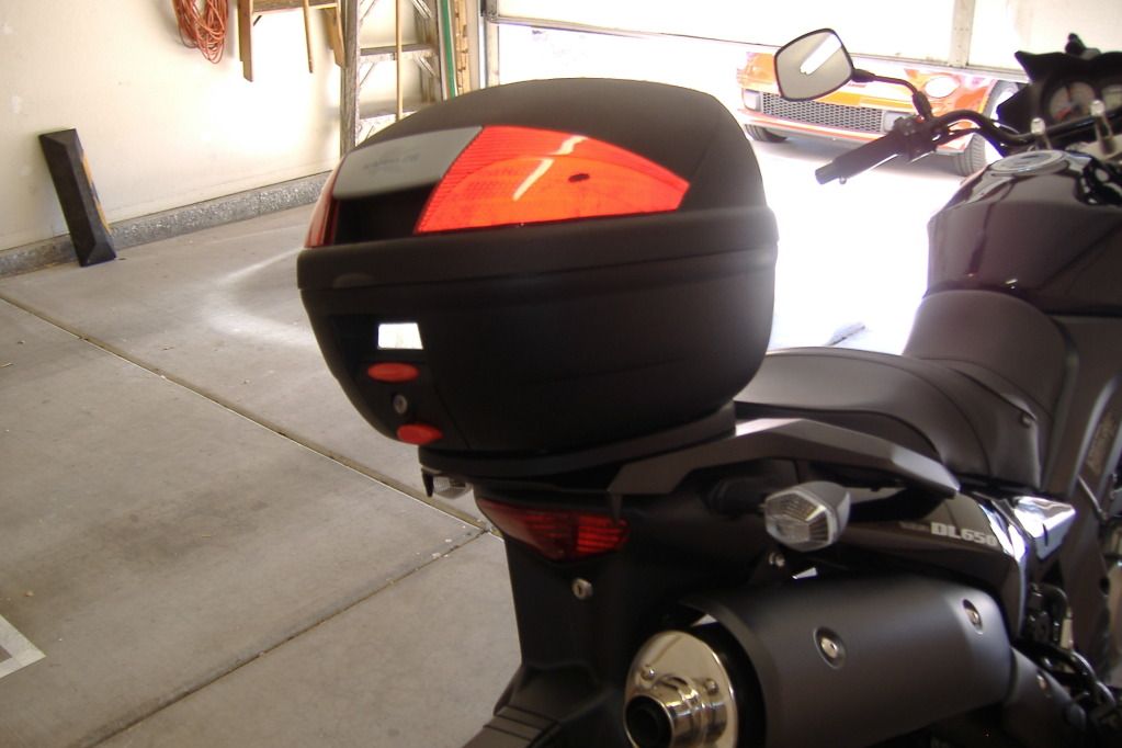

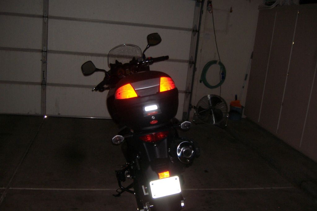

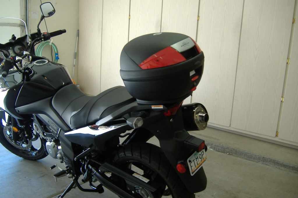

Next up my Kappa Moto K26 top case. At 26 liters this is perfect for my needs (commuting) easily holds my lunch , gloves, etc, and will hold my size large Bell Revolver helmet. It doesn't look too huge on the back of my bike and the fit and finish are excellent. I also followed another member of this forums idea of putting reflective tape behind the red lenses of the case to make them true reflectors, works really well (see pictures)

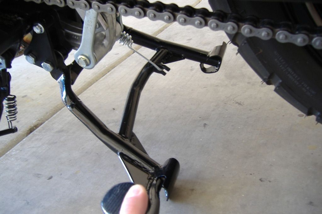

Next up is the Murphskit.com centerstand. Price is the best of any out there quality is good, fits as it should, took 1 hour from start to finish to install it. I used the (shoestring trick) as seen on U-Tube to install the springs. worked amazingly good. Springs went on so easily I thought I did something wrong! ( little tip if you are thinkining of doing this- I used 1/8" braided nylon cord bought from Lowes, wrapped the end I was pulling on around a screwdriver handle so I could have an easy grip. then I put a little grease on the cord where it slides along the spring hooks. slipped on super easy!)

Ok, a little follow up on the Muphs center stand. The kit includes a rubber bumper that pushes into a bracket on the underside of your muffler. This makes it so that when your center stand retracts it just kinda makes a dull thud instead of a loud metal clang. Well I was washing my bike today and had it on the center stand and when I retracted the stand...bang! What the hell? Looked under the bike and found what was left of the bumper, it had melted into a useless blob. Thi is after only a few hundred miles .They need a sturdier material. I am going to have to get creative and think something to replace it.

Not yet, my plan is to cruise around Lowes or Home Depot and look for something made of hard rubber that can be cut to size and either riveted on or glued on with some construction adhesive. When I figure it out I'll post some pictures. :)

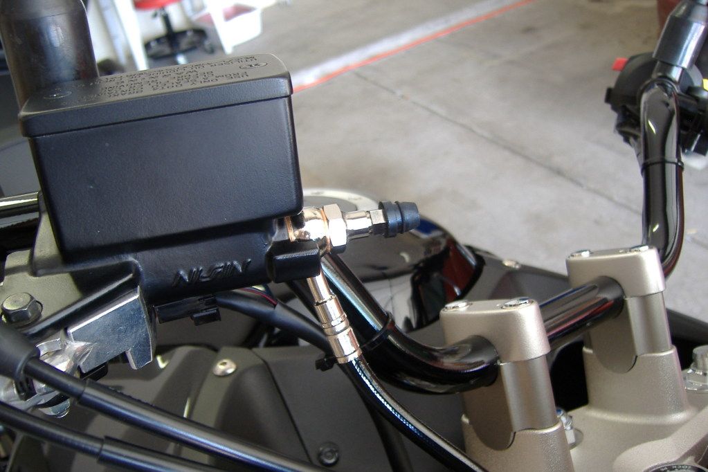

Hello again! finally got around to taking some more pictures. Here are my new Tusk 30mm risers installed. They arrived as shiny bare aluminum, so I rooted around in my garage cabinet and found a can of stainless steel colored spray paint, close enough! The risers also necessitated a longer front brake line since the stock one was streched too tight. The brake line is a Galfer from SV Racing, and is 2" longer than stock. also purchased the optional master cylinder brake line bleeder from SV. Note: the Galfer website has very clear and informitave videos on installation and bleeding techniques.

My seat fits as good as the factory seat. I don't have those gaps that you have. I do know that when the seat was new you have to make sure that you press down in the front of the seat while installing it to make sure that the front clip goes under the bar that holds it in place. I have read other peoples complaints that the seat doesn't fit and has gaps like yours does. I don't remember what the resolution was.

How does that stitched seam going across the seat panel fell on the butt ?
Doesn't look like a good idea ?
Im looking to retro fit my old 800 Tigers Sadleman seat to a used V-Strom seat base .
I kept it from the Tiger800 I traded ,cost heaps from the US to Australia ,but it was the best seat I've had on a bike .
Hope I can do it without stuffing it up .
I removed OEM seat on new V-Strom and raised that 30mm or so ..its good ..
