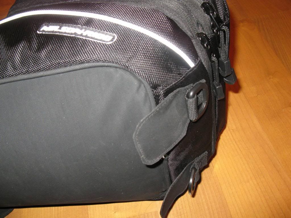

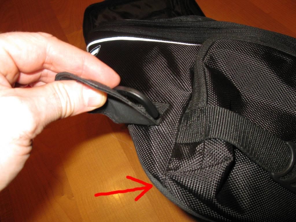

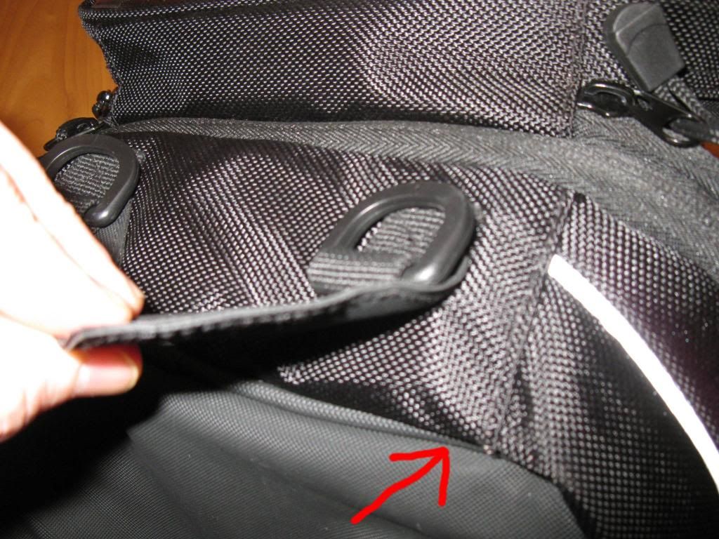

My strongest criticism is where the attachments points are on all four corners. They are not sewn to the bottom of the bag but up the sides about 2 inches from the bottom welting. The bottoms of the D rings are at the welting but the webbing they are sewn to is sewn 2 inches above the welting. What’s the big deal you ask? When you strap the bag onto the bike and cinch it down so it doesn’t move around the bag will collapse to the stitching point. Since the bag is only 9 inches tall closest to the rider and 5 inches at the other end of the bag, you effectively lose a considerable % of storage space in what is already a rather small bag. All of the other tank bags they make are sewn with quick release buckles sewn to the bottom of the bags. Why change a good thing???? Here are pictures of what I’m talking about. The red arrows are where I think the D rings should be attached at:
