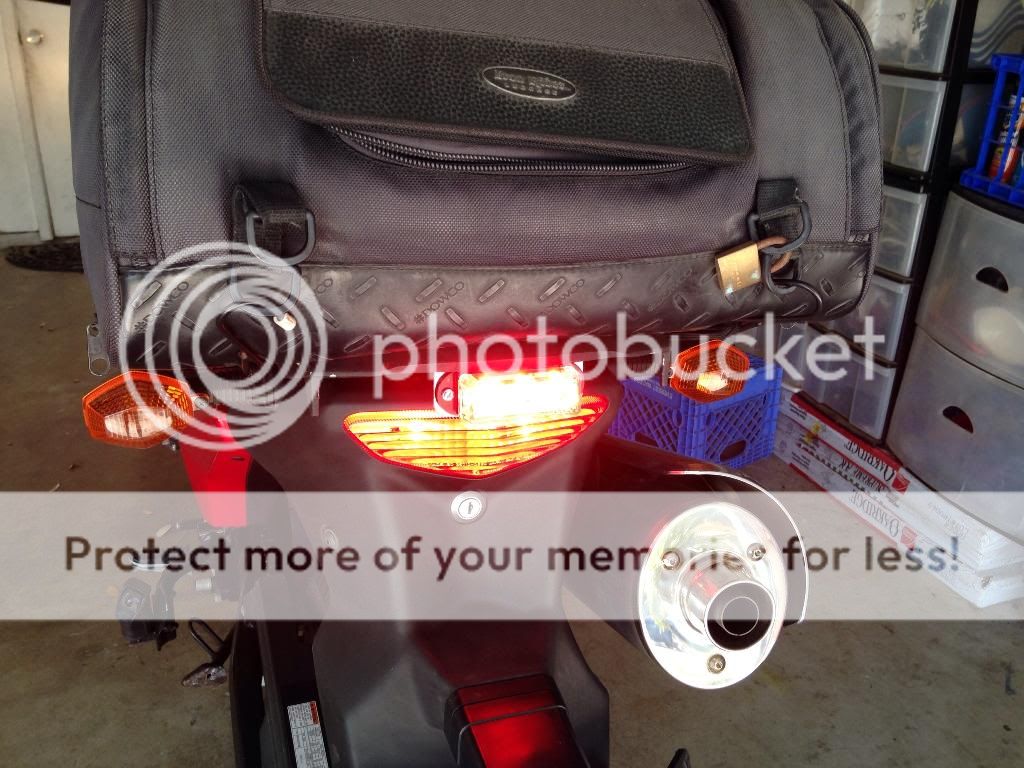

I have a tail light modulator, so I converted all my light bulbs to LED. When I put the tail light bulbs in (1156) with the brakes depressed, my LEDs and modulator modulate. I'm thinking relay? Everything works like they're supposed when I press the brakes on, but when I release brakes rear tail lights and modulator modulate, it does not do with regular bulbs.

Yes everything worked fine with the regular bulbs with the modulator. Only when I put LEDs in it modulated in depressed position. I just put the regular bulbs back in.
