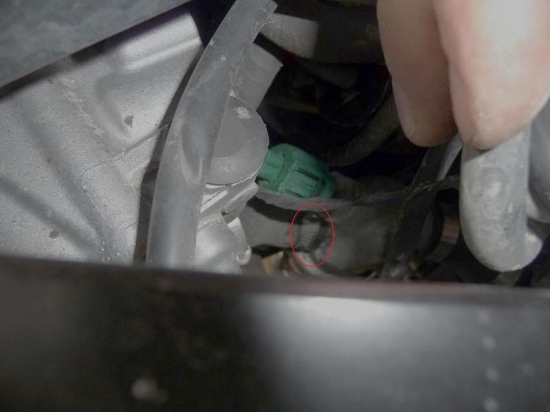

OK, how do I get to this:confused:
This is a slow leak and it is in a spot that seems like I have to take apart the whole bike to get to.
I sure hope someone has a nice little secret to this problem spot

Nope, no secrets, assuming you can't just snug up the clamp with a screwdriver from the side.
Remove tupperware, tank, airbox.
Drain cooling system.
Move throttle bodies out of the way -- you don't have to disconnect the cables, just remove enough stuff to get them out of the way while you're in there.
Since it's such a pain in the ass, replace the hoses, clamps, and any other o-rings and whatnot you can reach while you're in there.
Clean up any corrosion on the fittings, too, or maybe install new ones -- they're not all that expensive.
