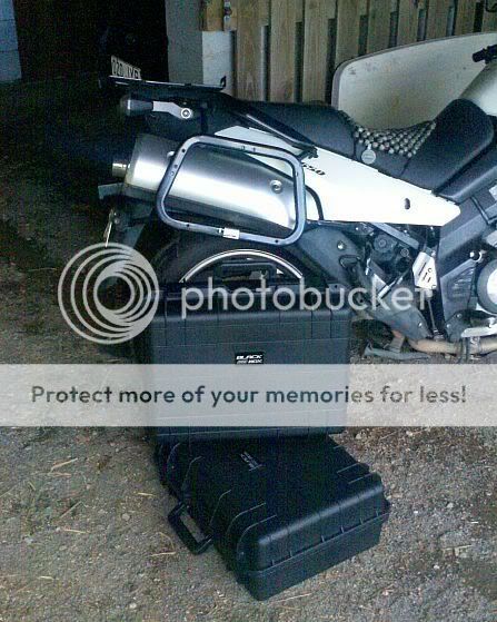

So here we have the cases and the bike:
Note that the bike has an exhaust on one side and the tool tube mounted on the inside of the frame on the other.

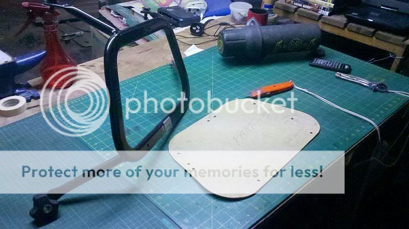

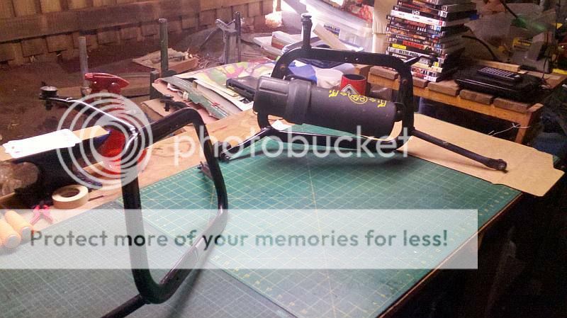

First step is to remove the frames and get them into the workshop:
The "face" of the two frames is the same but reversed, or to put it another way, the frames have the same holes in the same location from front to back.
Then - make a template. Always make a template if you ever intend(or might need to) make more than one of anything. In this case(pun?), there are two cases, so making a template was a no-brainer.
I can use the template for both sides as long as I remember to flip it over to point in the right direction. To this end the template has an arrow towards the front of the bike.
The template shows the outside of the frame and all the mounting holes already in it - I'll pick which ones I want to use in a moment.

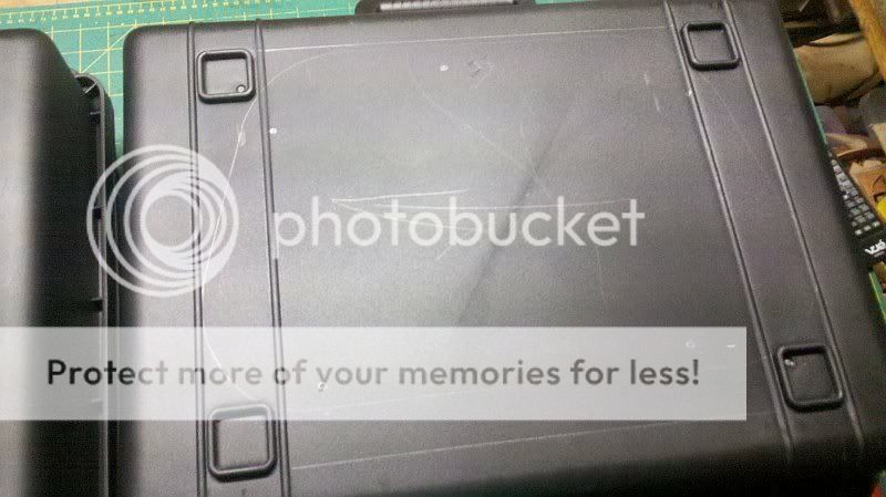

So now I mark out the cases - I've made use of the various lumps on the base of the case to make aiming marks. Note that the cases are also marked to show the front of the bike - so I just match to the template.

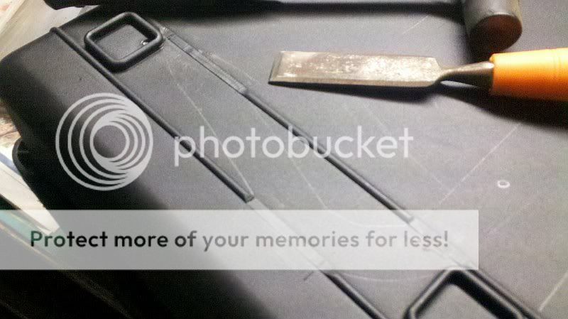

Next step is to remove the lumps that are in the way on the base of the case - I want the case flat against the frame to spread the load on the plastic and prevent vibration. Any strength lost by removing these ribs is offset by the firmer fit against the frame(ie the frame and case become one item rather than two things bumping against each other).

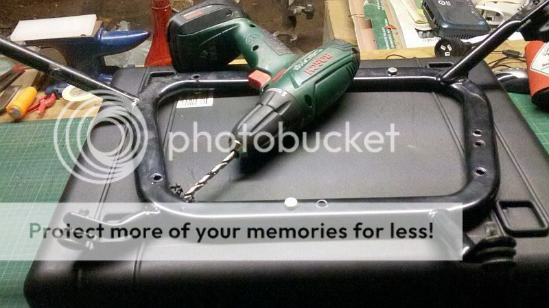

Now we drill - the first couple of holes have been drilled based on the template, once I have two holes I can use the frame itself as a drilling guide as I can bolt it down to stop it moving.

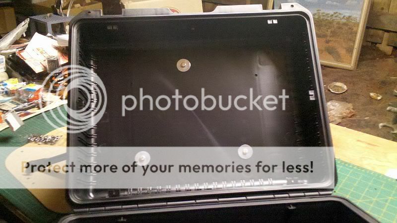

Here I've started mounting the case - inside the case is a body washer from an auto shop, the kind used to fit mudflaps. The idea is to pinch the case between the large washer and the frame - more contact means firmer fit and less vibration.
I've got the bolt heads inside the case and the nylock nuts outside(towards the bike) - using nylocks so they won't undo themselves as the bike vibrates. Two of the holes I selected to use were based on the mounts for my tool tube - there's going to be a bolt there anyways!

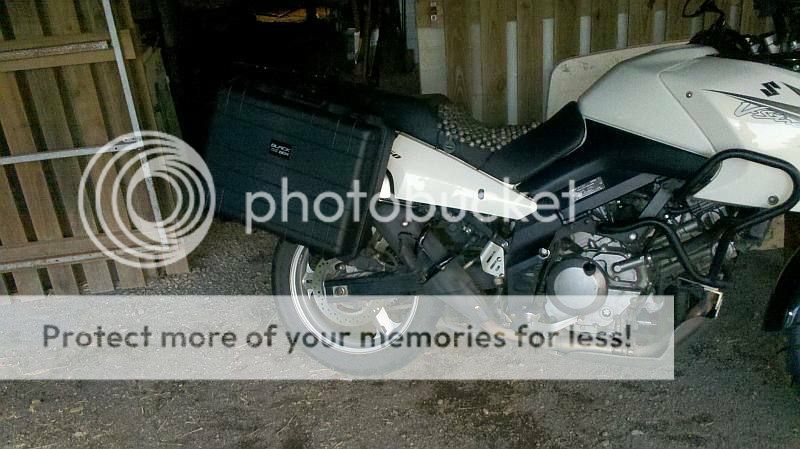

Once both sides are done, the whole lot gets remounted to the bike and I try to figure out how to get it through the door!
