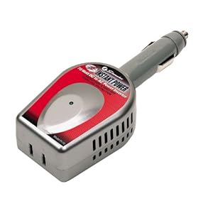

How do I calculate what size (wattage) inverter I need to charge my Netbook on the bike? Is charging the battery (with computer off) a lower draw than running the computer while plugged into the inverter (I don't plan to do this but that would be the max load, I assume).

Thanks guys. so the charger output (what it sends to the computer) is 19 volts at 2.15 amps, giving a draw of 40.85 watts. I have a 75 watt inverter, so even with parasitic power loss, it should do fine. Someone (salesman) suggested I needed a 400 watt inverter.

Yeah, you should be fine assuming the rating is calculated properly and the 75 watts is output rather than input. Nothing wrong with the 400 watt suggestion though. Higher capacity means things run cooler.
