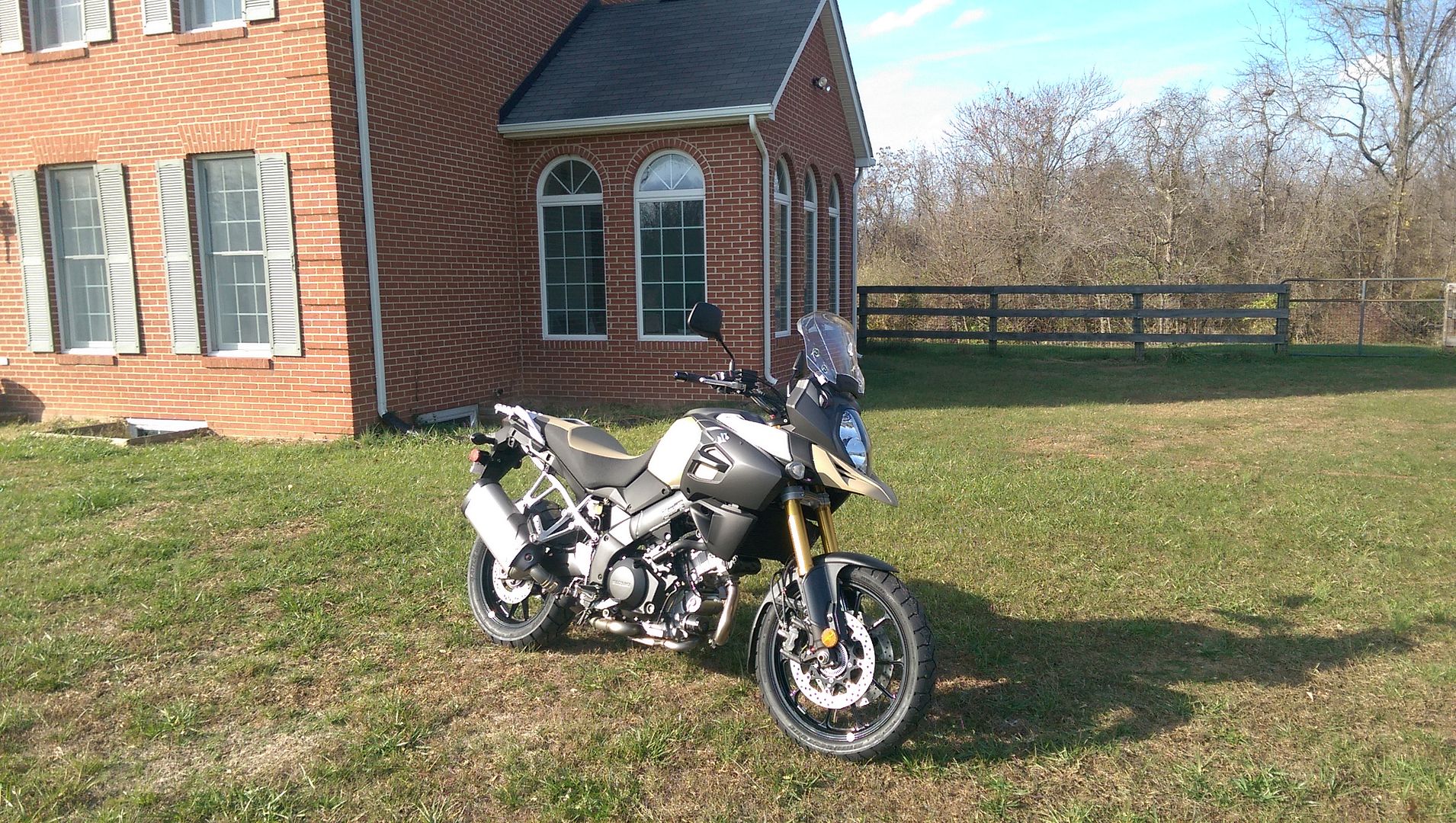

I bought a new 14 today from Romney Cycles. They really treated me right.
I'm going to see if I can scrub off half of the 500 miles to the first oil change now!
Beautiful! Congrats............
