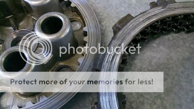

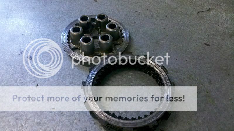

About 88000km. I think the stator was a byproduct of the clutch slipping and engine overreving slightly on a hot day......
Those plates have to have been wearing for a long time - and given the amount of slow riding I do with my commute I think it's likely that's what caused it.

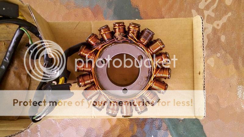

Is a fried stator the ugliest thing in the world or what? :thumbdown: I've got my old one nailed up on the wall as a reminder of the most exasperating ride I've ever done. Maybe I should flick it and get rid of the bad karma.
And Penguineer where's all the friction material from your clutch? Did it really wear down that much? I'm not mechanically minded but that looks like one stuffed clutch to me.

Back to the workshop --- when I replaced the stator I just went OEM but I changed the R/R for one of the Mosfet type on the recommendation of Greywolf mainly and it's been fine so far. I'd swapped the battery earlier in the vain hope that this was the problem and not the stator, so I now have a new electrical system, and I've taken the strain off the front of the bike by fitting one of Eastern Beaver's headlight relay kits.
Absolutely cactus. That's only the worst of it - there's supposed to be friction material on the plates at least. There's a couple of other plates that are showing quite heavy wear, including another that's almost down to the metal.

I'd guess that the damage is being done with my regular commute to work - quite reglar slow downs(>20kph) due to traffic incidents, traffic lights etc - it's lasted over 2 years so I reckon that's doing fairly well for the abuse I've dished out to it.
I've been considering the RR change and the headlight relay, but I've been stuck with this idea of not changing the base bike too much. A new battery is a possibility in the next six or so months I'd guess....the headlight relay could still be a goer......

Buy New Stator Suzuki DL650 V-Strom 2002-UP SV650 (03-07)
I thought the electrosport stator was higher output but less reliable? I've already crisped two stators.......
