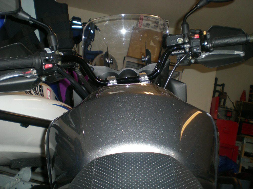

I have been thinking about some new bars. Here is my old set up:
As you can see, stock bars... Rox 2" risers. It made the cables / hoses just a little too tight at full lock, especially the clutch hyraulic line.
I I wanted it to be just a tad lower, and lose just a tad of the sweep (how much the outside of the bars come back).

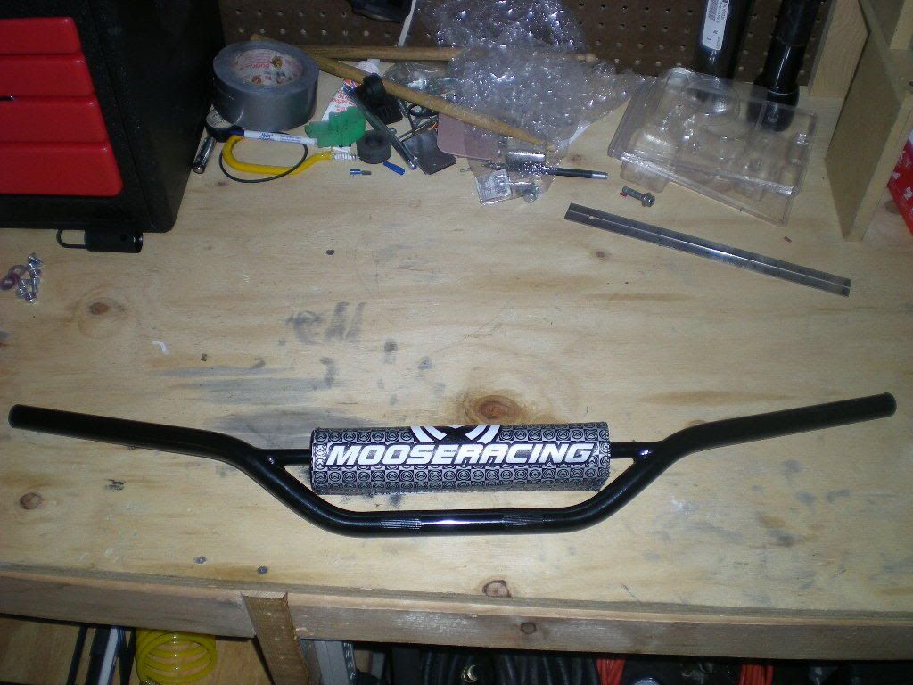

I thought about Moose ATV HI and Moose CR HI. I chose Moose because they are cheap, they are 7/8" for less mod's and they are at my local motorcycle shop. With the ATV's I would have removed the Rox risers and just had the bars. However, the ATV's had a lot of sweep (or pull back, like stock), so I opted for the CR HI bars. Lower but less pull back.

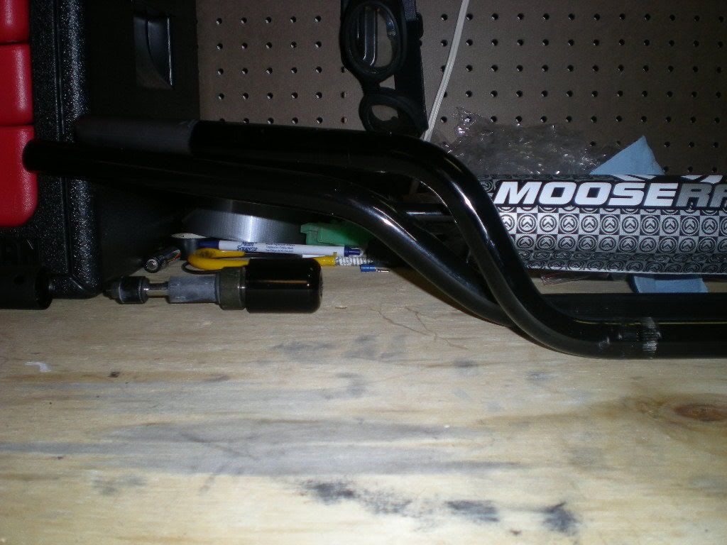

Here are the Moose racing CR HI bars compared to the stockers. I don't know how easy it is to tell, but the stockers are taller than the Moose bars, and the stockers also have more pull back. I tried to make the photo as clear as possible... sorry if it didn't turn out.

Finished product:
After a short ride, I like everything accept for the longer reach. These bars are shorter than stock bars and I would not recommend them unless you have bar risers. Even with the risers, I miss the added height.
I like the look. I like the feeling of more direct input. I like the much reduced sweep. I like the quality of the bars.
I don't like the extended reach. I don't like the cheap pad cover that comes with it, I left it off.
If I don't get used to it in a few days, I will try the ATV hi bars without the ROXs. I'll let you know.
