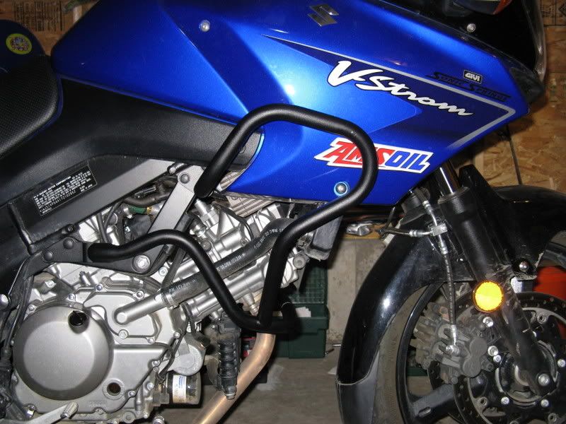

I installed the Givi Engine Guards yesterday....and WOW do I like the looks. IMHO, these are the most attractive guards on the market.
Of course, the trying test will be if I tip or lay it over. Hopefully, I plan to never have to report on that happening!!!!

There are two or three good places to order. I started to order through Twisted Throttle, but simply did a Google search for "Givi DL650" and found a company selling them for the lowest price with free shipping (I think that was a Christmas special).
By the way, I have read from several that they had difficulty with the installation. I will admit that the Givi instructions suck and say nearly nothing, but putting on the bars is straight forward and only took me about 45 minutes.

I've got Givi guards ready to go on. No thanks to the instructions I've figured where all the parts go though.
My problem. The four bolts per side that need to be removed. Mine are extremely tight (K9). So much so I'm afraid I'm going break the bolt or the Allen wrench (from the Zuki tool kit).
Any suggestions?

To get my bolds out, I used vise grips to "mount" an allen wrench to my breaker bar (dumb). It worked, and I used it to tighten the new bolts back up, but I couldn't get them tight enough. Went to Sears and bought the allen wrench sockets... that's the way to go. no problems.

Yep, these puppies are heavy with Lok-Tite. I used a 'cheeter bar' over the Hex Wrench and they easily broke. Yeah, it is a little scary....but all eight worked spendidly and spun free. After the first one, it was a piece of cake.

hollowas and jnoflane2. Knowing what to expect and having the right tools makes a world of difference. The guards are on and look great. They seem to be quite strong.
I also warmed the bolts a little as my garage is not heated. I supported the engine some with my floor jack just to make sure nothing moved around with all those bolts out.
