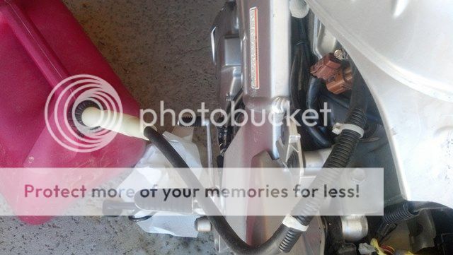

I set up a drain hose from the tank into a gas container.

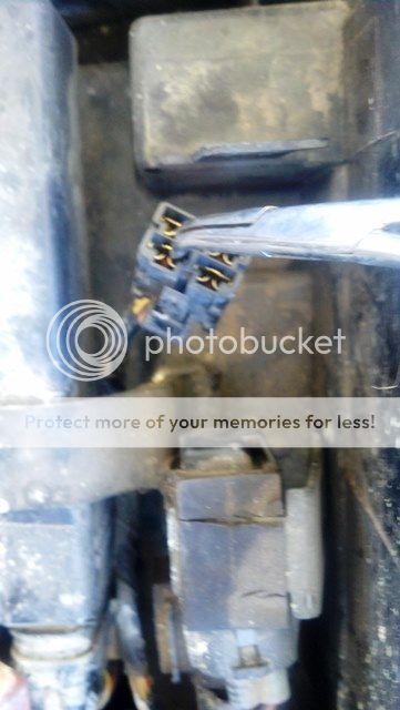

Used something to hotwire these two terminals in the plug that goes to the fuel pump relay.

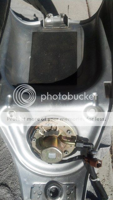

Here's the bottom of the tank, which is on a soft towel.
My outlet hose may be different than yours, as I have performed the external filter mod previously.

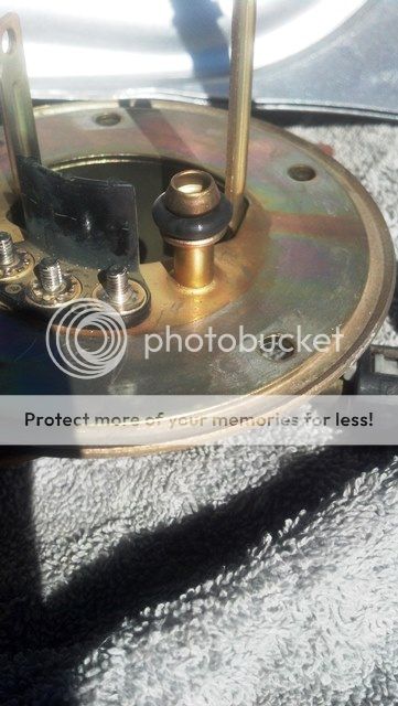

Removed the pump. Was careful not to bend the float arm.
Removed the four wires, the screw to the short stem and the two screws at the top for the float/sender. Remember where it all goes, MoDaddy.

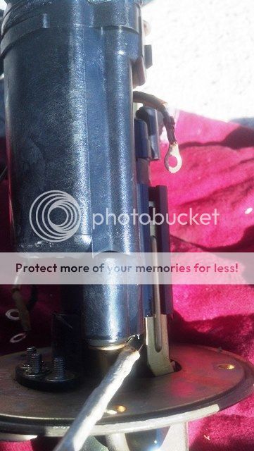

Pried here to get the assembly out of the base.

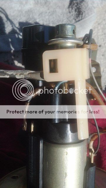

Pried here GENTLY to get the regulator clamp/cover off.

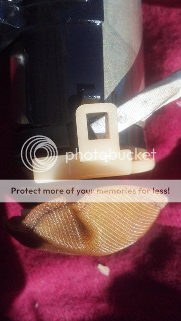

Pried here GENTLY to remove the inlet screen clamp off.

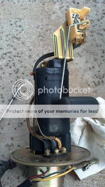

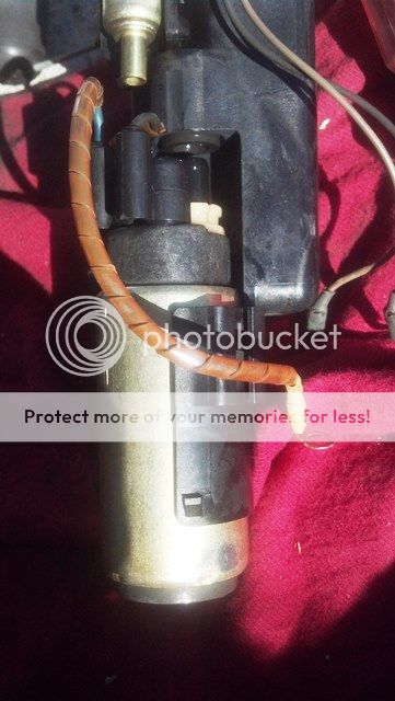

Pulled the pump down out of the filter assembly.
Removed the wire terminal cover and wires.

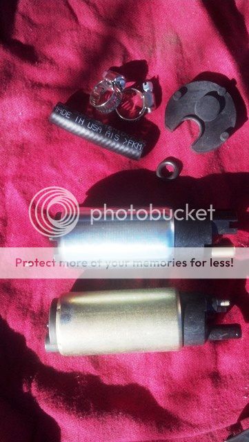

Here's the old pump and the new pump and kit.
The new pump is about 5mm shorter than the original. I don't care.
