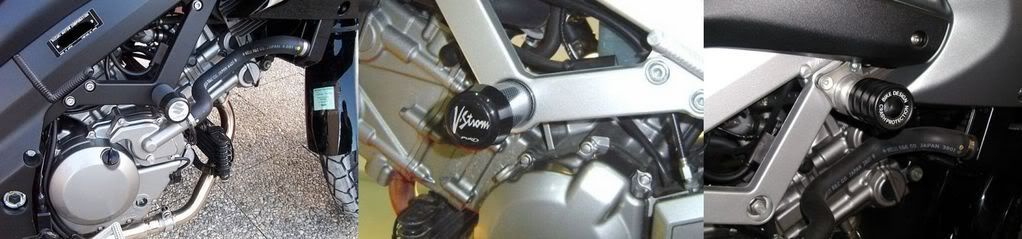

Okay, so a large number of us seem to agree that the Strom needs some help… down there, be it to protect the life blood of that wonderful (SV/DL650) power plant or simply to literally fill-in where Suzuki designers seem to have left off. Like many of you, I found the eye candy effect of JMV’s lower fairing very appealing. Here in Canada, this fairing is sold by Clary Sports in Saint Donat, Quebec. Unfortunately, as beautiful as this fairing is, the stock version is not compatible with any frame sliders – that I’m aware of (DL1000 owners read on). So, on to my next search…a JMV-slider solution.
…With Sliders
I first looked at the Motovation sliders which, because they mount via the main engine thru-bolt and have a large base, would appear to be able to withstand both large compression and shear forces – like good sliders should. Suzuki’s and Puig’s also mount here and would also appear to be quite robust. Of course, from what I’ve learned, the critical factor is the slider’s ability to self-destructively isolate the frame from these impact forces so its material make-up is paramount. I’ve also read that the discontinued “super sliders” were quite popular with V-Strom riders since their extra extension allowed them to clear engine guards while protecting the fairing protuberances.
However, I determined that all these sliders on a Wee would pass through the JMV fairing at the “main rib”. I then found Bike Design’s sliders on the web (below R) which mount at the upper engine mount via BD’s own offset flange.
Fig. 1: Suzuki/Puig/BikeDesign Frame Sliders

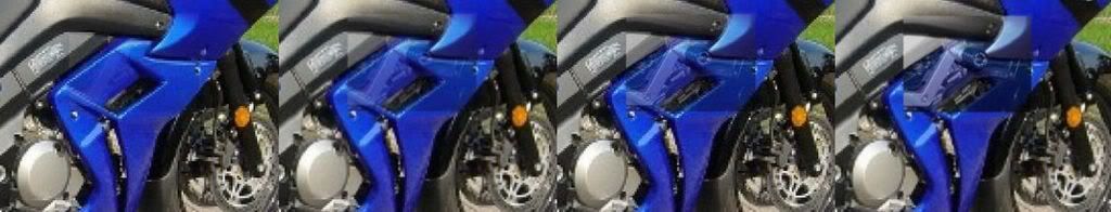

The BD sliders looked promising so I borrowed a forum photo of a Wee – thanks for the use of your photo Jim Burke -- which was taken at almost the same angle as BD’s photo then superimposed and faded them as shown below.
Fig. 2: Frame Slider Exit Locations On JMV Fairing
As you can see, the Motovation/Suzuki/Puig slider would appear to emerge approximately at the rib while the BD slider would appear to emerge near the upper corner.
Clary Sports was very supportive in my effort to find a JMV-slider solution. They informed me that JMV offered to work with them to fabricate a painted fairing with frame slider mounting holes – for the same price as the stock fairing -- and that Clary could provide a BD slider bracket which was compatible with these holes. However, as it turned out, this JMV-slider solution is only available to DL1000 owners and mine is a Wee.

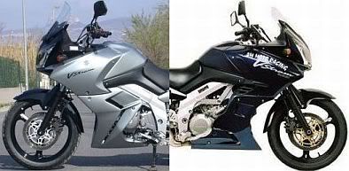

While perusing BD’s web site, I came across a JMV alternative from Espace Tuning. As you can see from the comparison image below, unlike JMV’s fairing, ET’s is open on the sides so it doesn’t interfere with sliders. However, I personally prefer the finished appearance of the JMV fairing.
Fig. 3: JMV vs Espace-Tuning Fairing
Since I couldn’t find the fairing-slider solution I desired -- and since I reconsidered the high $C790 purchase price of the JMV fairing, I’ve moved on to engine guards – but I’ll save that shopping process for a future posting.

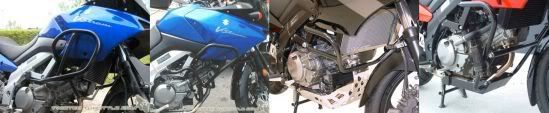

Engine Guards
The 4 most popular engine guards are:
1) Hepco&Becker (Germany),
2) Givi (Italy)
3) SW-Motech (Germany)
4) Pat Walsh (USA)
As can be seen in the side-by-side comparison below, both the H&B and Givi guards extend up and around the fairing to protect it in the unfortunate event of a tip-over on soft ground. On the other hand, both the SWM and PW guards sit almost flush with the lower edge of the fairing. All can be combined with skid plates but since the PW design only uses one upper anchor bolt on each side of the frame, it actually uses its integrated skid plate as a supporting member of the guard.
Since the V-Strom’s engine is suspended below its frame, any engine guard can only be of a side shield design with the crossbar forming a type of parallelogram with 2 of its vertices anchored to the frame. Hence, any side force would likely push the impacted side in and the opposite side out – the effect likely more pronounced with higher crossbars. The greater the engine guard’s bar strength, the less the distortion but the more difficult to remove the distortion after the incident. However, if the engine guard is supplemented with frame sliders, then on solid ground at least, the sliders should minimize the distortion – and therefore the likelihood that the guard will be pressed against the fairing.
Fig. 1: H&B vs Givi vs SWM vs PW DL650 Engine Guards
An excellent side-by-side photo comparison of Givi vs SWM crash guards- is posted at this French site: http://dl650.free.fr/photos/accessoires/protection/comparo-crash-bars.html and includes the SWM ground clearance shot shown below - for those of us who don’t want to lie our bikes down in the name of science ;). Note that the hand guard and bar end appear to be contributing to (if not providing) the protection here – and likely saving the stock front turn signals from breaking off as they apparently tend to do. Hmmm, think I’ll add reinforced hand guards and flush turn signals to my farkle list.
Fig. 2: DL650’s Tip-over Clearance With SWM Guard
Twisted Throttle tells me the H&B, Givi, and SWM guards all weigh “around 8.5 to 9 lbs”. However, given the reported superior rigidness of the H&B guard, I’d expect it to weigh the most – or at least the same as the Givi but more than the SWM which is physically smaller than both. Forum issues have been reported with some early versions of the Givi guard cracking at the mounting points and with some suffering premature rust and vibrations. The PW design with integrated skid plate is the most cost conscious solution. As with the V-Strom itself, the aesthetic appeal of the various guards – or lack thereof -- is in the eye of the beholder J
I myself am leaning toward the PW design since:
a) The combo cost for guard with skid plate is attractive,
b) The vertical bars provide good mounting points for auxillary lights – I don’t use the highway pegs shown in Fig. 1,
c) An integrated metal mesh is available from PW – or can be fab’d – to protect the oil cooler,
d) The engine thru-bolt remains open for installing frame sliders,
e) Customer Service has been reported as excellent
f) Pat has been reported as “good people” – and don’t we all feel good supporting good people ;)
g) I figure a hard dump will distort any engine guard – as any good energy absorbing device should do. So, adding extra weight and moving the CofG higher – on a bike with an already high CofG -- are exactly the opposite of what I personally want to do.

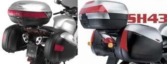

Soft and hard saddlebags are available. Up to now, I’ve used soft saddlebags and learned to live with wrapping my clothes in plastic to keep them dry during heavy rain. However, it’s time for another change so I’m shopping for hard saddlebags. The most popular brand here in Canada seems to be Givi. However, Shad’s cheaper (??) clone luggage (see below) is also popular.
Fig. 4: Givi (E41side+E52top) vs Shad (SH43side+SH48top) Luggage
Twisted Throttle’s site has an article on Shad luggage compatibility with SW-Motech’s racks (http://www.twistedthrottle.com/article/view/120/1/18). Motovan is the Canadian distributor (not retailer) for Shad luggage.

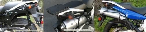

The most popular side racks seem to be by SW-Motech and Givi. Hepco&Becker also make side racks but Twisted Throttle’s site page for H&B’s side racks (https://www.twistedthrottle.com/trade/productview/627/203/) makes a convincing case for choosing the superior SWM system (https://www.twistedthrottle.com/trade/productview/272)
Fig. 5: SWM vs Givi vs H&B DL650 Side Racks
I’ve decided on the Givi E36N’s (not NJ which lacks internal document strap and reflector) but since they come with an integrated red pinstripe – did I mention I ordered the blue Wee? – I’ll have to add ColorRite’s touch-up pen/jar to my farkle list. Mounted to SW-Motech’s quick lock side racks (via required Givi adapter kit) and secured – along with the racks -- with SWM’s optional locks, they should serve me well for years.
