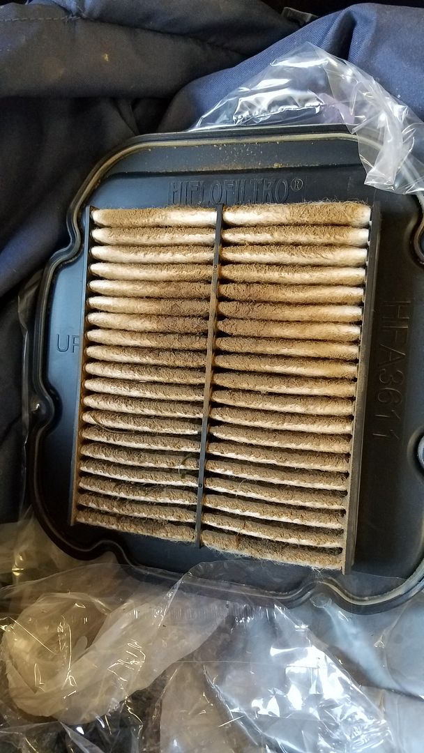

I was doing some electrical work that required pulling the tank so while I was there I had a bit of a looksee at the air-filter. Mostly it has been serviced at a shop, so it's not something I look at very often.
My first observation is that my filter seems a bit dirty given that the service mob ostensibly changed it less than 5,000km ago. Those km have mostly been on sealed roads. At first I thought it might have been some spray-on solution that some air filter like K&N use, but it doesn't feel like it, so I'm curious what the hive-mind thinks. What do you think? Typical for 5,000km or typical of the service mob not changing it?
I ask this because I know that getting to the air-filter is quite a pain, so easy to avoid.

I wouldn't say that filter is too bad. I would leave it in there for another 5K.

Agree, that filter looks okay to me. Normal dust which means it is doing its job.

Me personally? That air filter is done, new one swapped in at this point. The other stuff? Oil mist coalescer that is normally made from a structured plastic (similar to a lawn mower air cleaner foam) but in this case looks to be a stainless steel version. Me? No way a bunch of steel crap is going to be in my airbox where it might disintegrate and be sucked into my engine, but there are lots of people who think the 'Zook is a BMW and there is little reason to worry. The dark staining on your air filter would seem to indicate that the metal stuff does not work as an oil coalescer as expected...the crumbly nature of it would indicate that the environment it is in has caused it to degrade and that it should be replaced with a structured plastic designed for the purpose. My 2 cents and worth about the same.

Filter is probably still good for a while but it's not that expensive so why not replace it anyway while your in there? That way you know its clean and will last. Can't answer about the metal filter. I don't think I would be to crazy about having metal in there for pieces to get sucked in the engine either. I would see what Suzuki has as OEM and go with that.
Yep. My local Mr Suzuki has ordered a 3rd party filter as they no longer supply EOM. Figures. I probably could have gone on ebay just as easily as they did... Oh well, lessons learned.

I'd probably replace that filter, but that's just me. It's kind of a pain to get in there and I'm not as cheap as some of my fellow strommers. I keep a new one on hand and whenever I'm in there, if it looks questionable, I swap it. Usually a couple of years / 10k miles-ish. Depending on what you're riding through (like wildfire smoke in the western US), it can saturate surprisingly quickly.

That looks older than a 5,000 km filter to me if it has been riden on asphalt.

A tip for when you do install the air filter, remember to put a light coat of grease on the area of the air filter seal that comes into contact with the airbox base and lid. This will help to keep any dust from bypassing the air filter when riding in dusty conditions.

While that air filter is a long way from the end of its service life Suzuki made it a PITA to access them so I'm probably replace just because I already had the bike half was disassembled to get the the air filter.
FWIW I do not condone the use of pleated oil gauze type filters like K&N and I hate to pay the price of OEM so I use aftermarket like HiFlo air and oil filters.
