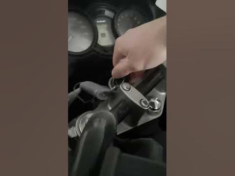

Im a new motocycle owner and this is my first bike/
I bought this motorcycle and it was running good. I had it stored for 2-3 months, i wasnt able to drive it.
I went to check the bike and it wont start. After some search on google, it could be battery or maybe fuse?
Here, check the video please
The key is on, but nothing happens
1,204 Posts
Dead battery for sure. You'll need to put it on a charger and see if it will still hold a charge or just replace it if you know it is old. A battery shouldn't die after sitting for just 2-3 months so there is probably something draining the battery or the battery was bad in the first place.
