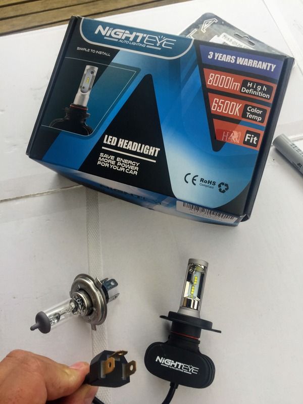

Hi all, a bit of a warning for you all regarding Nighteye LED's
I bought these H4 hi/Lo ones from eBay, for a good price (approx $40aud).
I figured what the heck, coming with a 3 year warranty.
Delivery was good, packaging is good and install was really simple.
The lights worked well at first. I switched them on and off, tested Hi and Lo beams. All good.
I then shut the bike down and installed my new risers, up 26mm back 20mm. No worries, the wires are all clear and not stressed at full lock.
I then fire the bike back up and the Lo Beam fuse pops. Hi Beam is working fine.
I check the wiring around the forks and headset as I thought I may have damaged something while installing the risers.
It's all good.
I try the spare 15A fuse and turn the ignition. It pops straight away.
Two fuses down, I decided I needed to isolate whether it's the new LED bulbs or something else.
I disconnect the LED, pop a new fuse in and fire it up. All good, no fuses popping.
I put the old halogens back in and all good. Hi and Lo Beams are working correctly.
So, a heads up guys, these things are likely to pop a fuse!
It is strange, however, that they initially worked and only started popping the fuse after a few minutes and after installing the risers.
Pic of product:
Cheers
Chris
