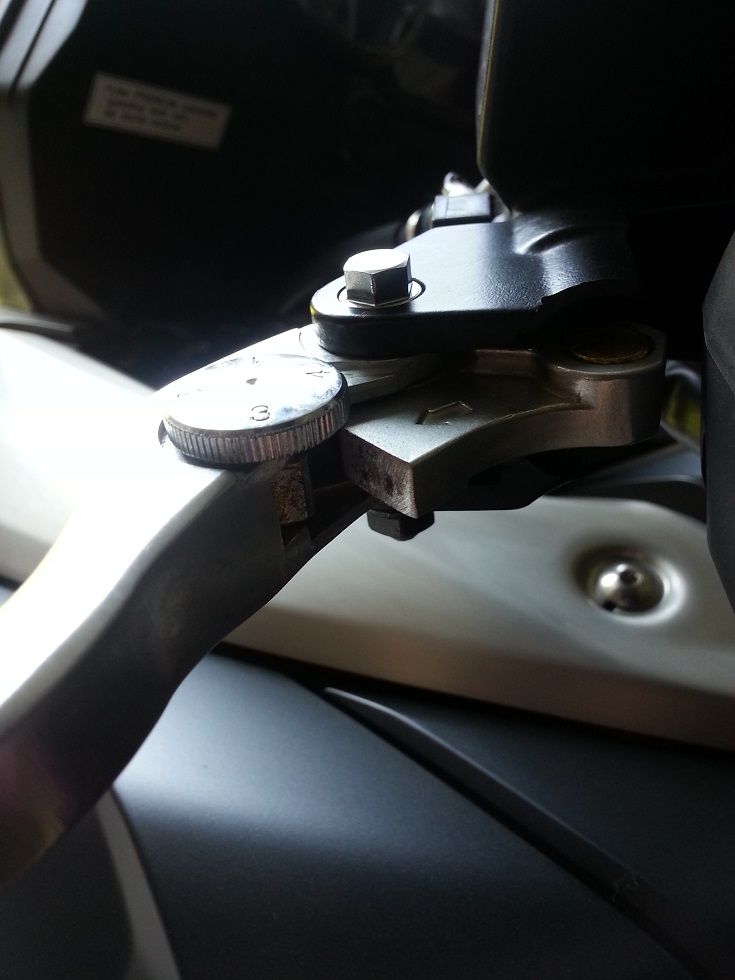

One common question about the hydraulic clutch on a DL 1000 is that the takeup point, or where the clutch starts to move the bike forward as you release the lever, is very close to the end of the levers travel. It is not a mechanical problem, once you know it will not cause the clutch to slip most just get used to it and don't think about it. But I ride other bikes and the difference in takeup points is enough that I found myself really wanting to do something about it. Below is a pic of the lever at rest for reference:

Petey, there is more movement. Similar to what a cable clutch lever will have. I have had no issues with the switch making contact. I don't even notice the "slack" when riding. Nothing negative to report, I have put about 1500 miles on it since. Huge difference in feel of the clutch like when doing tight u-turns, etc.
Just don't get carried away with how much you cut off! A little goes a long way and it is so easy to do you won't mind putting it together a few times to test it.

First let me say I when I was out for a ride today I found my clutch lever took quite a bit more effort than I remember. I was wonder if I was getting weaker in my old age (56)? After searching this great forum, I came across this mod and remember see it before but deciding against it because I didn't want the "extra" play at the beginning of the lever stroke. Then I read in another thread that while the aftermarket levers made things better, the actual force to engage the clutch was the same. So I decided to go ahead with this mod figuring if I didn't like it I could just order another new pushrod piece and try after-market levers.
I went on the cautious side and only removed 2mm. Most importantly, I cleaned up the entire lever assembly removing old grease, polishing with Scotchbrite and steel wool all the pivoting surfaces. After putting everything back together with plenty of fresh waterproof grease and I took the bike out around the house for a few blocks. It felt like a new clutch. I felt no looseness at all. There is a spring in the lever adjusting knob that I believe helps keep the slack from shortening the pushrod to a minimum. The clutch engagement point is closer to the bars so it will take some getting used to but the effort was decreased by at least 30-40% or so it seems. From beginning to end the job took me about 30 mins and I'm not pro mechanic by any stretch of the imagination. Thanks so much for the information. I would suggest this mod to anyone wanting to improve and ease the clutch pressure.

Hogsniper, glad you appreciated the mod! While it technically won't change the actual clutch lever pressure needed to actuate the clutch, the fact that your fingers get a much better hold on the lever sure gives it a LOT better feel.

This mod does not change the friction zone. I think hydraulic clutches have a smaller friction zone than cable clutches and the Vee's is too far from the grip for me. Especially if you ride other bikes frequently that are more standard in clutch takeup. While the adjustment knobs do help, this mod goes further than they can.

There are no threads on the rod. I made my first cut with a Dremel tool with the abrasive cut off wheel. Then I used a file to fine tune it and dress the edge/square it. A little at a time is the way to go! For instance, start with just the width of the cut off wheel. They try it. Very easy to try it, you don't need to tighten everything down, just put the bolt back into the bracket/lever assembly and see what you think.

There will be a little "slop" as you call it. Seemed to me to be a lot less than a typical cable clutch. I never had any issues with the clutch lever switch or anything else.
The reason this works so well is that it allows your hand/fingers to get a much better grip on the lever before the tension picks up. Much easier to compress the lever with more of your finger on the lever instead of just the tips of your fingers. I rode in heavy Houston traffic and the position of takeup and the fact that the Vee has a rather heavy lever pressure required made my hand actually hurt after a while. This mod helped a lot.
