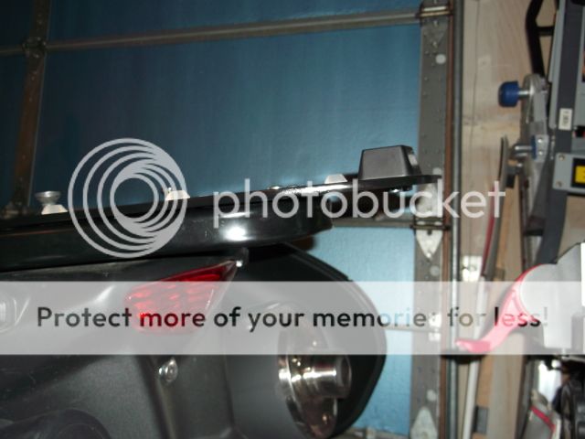

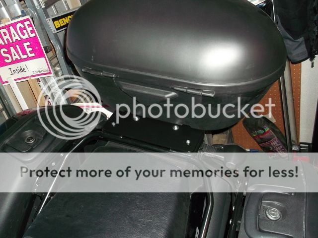

Well I had some time between family events this weekend and managed to get some stuff added to the Wee. I installed a center stand from Murph's, A SpeedoDRD from 12oClockLabs, A power receptacle from Eastern Beaver, I wired in the power supply for my Shark GPS, and I made a plate to move my top case back a few inches. Here are some pics of the top case plate.
I made the plate out of some 1/4" 6061 T651. I rattle canned it black and mounted it with some new hardware. I used longer bolts/screws to attach the case mounts and applied blue locktite to everything. It is rock solid and it even allows me to remove the seat without taking the top case off (I was never able to do that before). The little squares are some stick on bumper pads I picked up at a local hardware store. I took it for a ride and there are no rattles at all from back there and my speedometer is (to quote Marisa Tomei) "dead on balls accurate".
