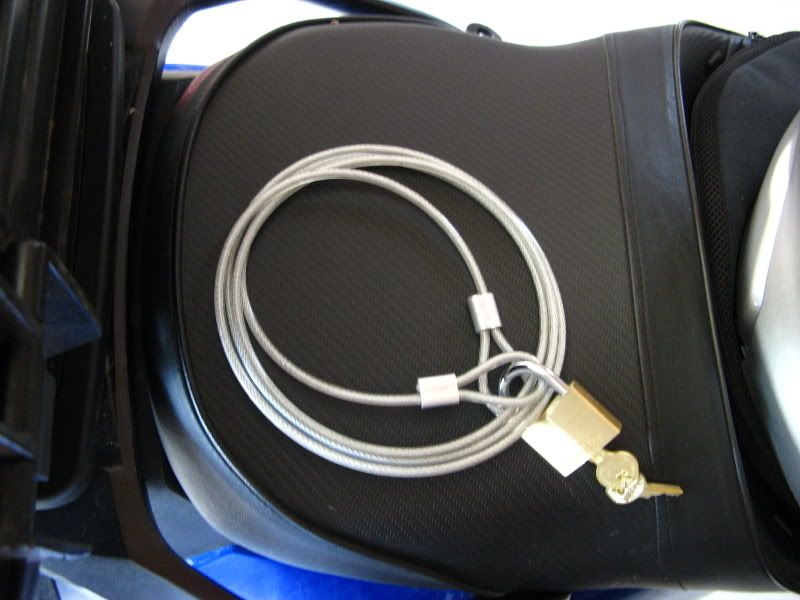

Coil it upon itself, slip the lock shackle through the loops and capture the coils to keep a tidy unit.

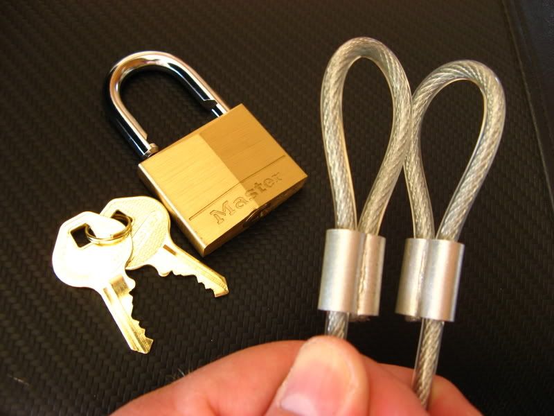

Close-up of the sleeves to make the loops. You are supposed to use matching size sleeves to the cable, and it says if using vinyl covered cable to strip the cable to get it through the sleeve. I wanted my loops to be vinyl covered, so I cracked open the packages of bigger sleeves and found one that would accept the vinyl covered cable. My cable size (w/o jacket) was 3/32", and the sleeves I used were 5/32" which slipped perfectly over the vinyl jacket. Slip the cable through the sleeve to make the loop, then put a wide slotted screwdriver set into the slot recess of the sleeve and then give it a couple moderate whacks of a mallet or light hammer to crimp the sleeve down on the cable. Do this from each side of the sleeve. Don't bash too hard, this is just aluminum. Electrical tape around the sleeves will help prevent accidental paint scratches to your bike.

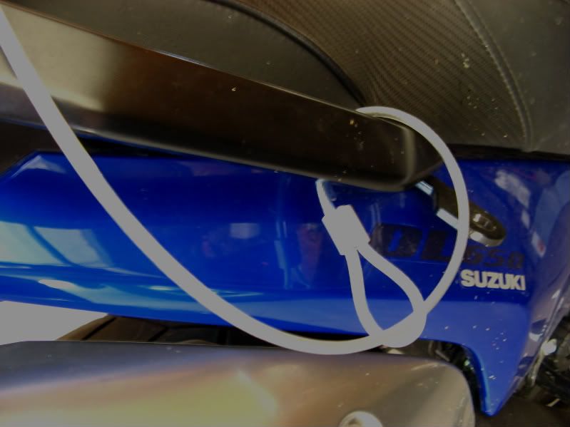

The passenger grab rail makes for one of the best capture spots on the bike. Use any similar capture point on the bike.

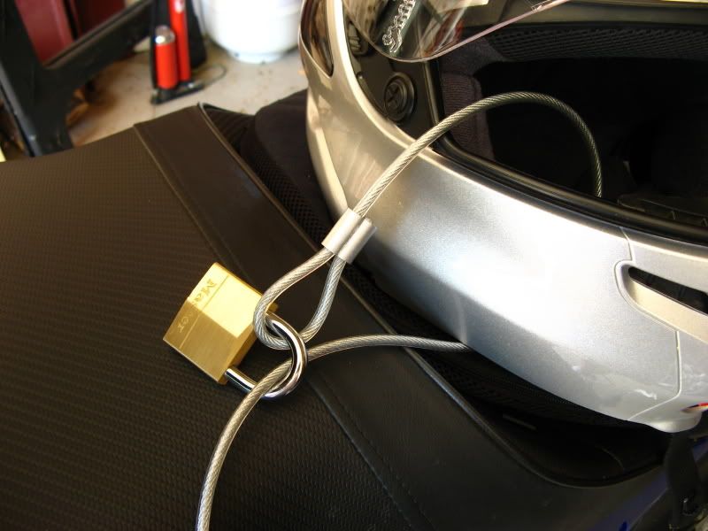

Here is the cable set through my helmet. No chin bar? Grab the strap D-ring. Yeah, a 6' long cable to secure the helmet only is overkill, and the helmet could fall off the bike seat to the ground (if that's where you set it, but it would be the perfect length if you set the helmet on the ground), but with my 20' roll of cable I bought, I can easily make a couple shorty cables (22-24" piece, put loops on each end, results in a 12-14" long cable, perfect for a helmet resting on the seat).
